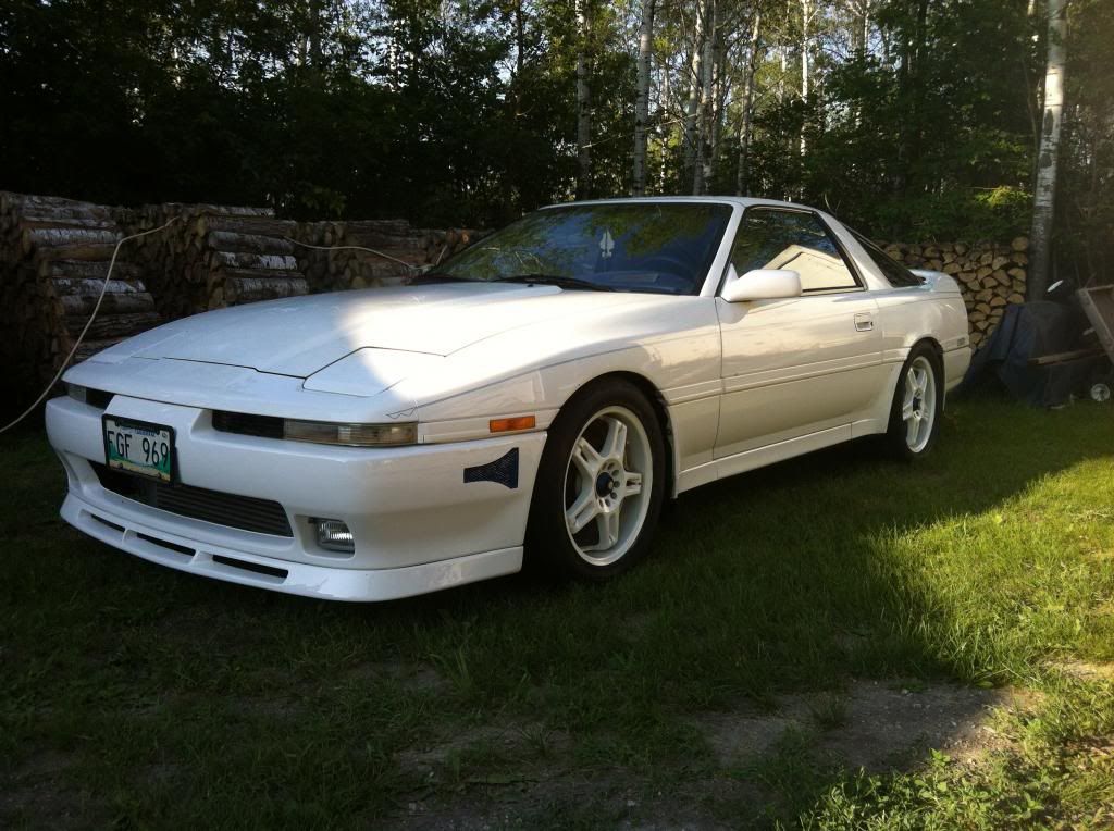

Hey guys, i'm JJB from Steinbach Manitoba Canada. This is my mk3 that i have not driven in 3 years!

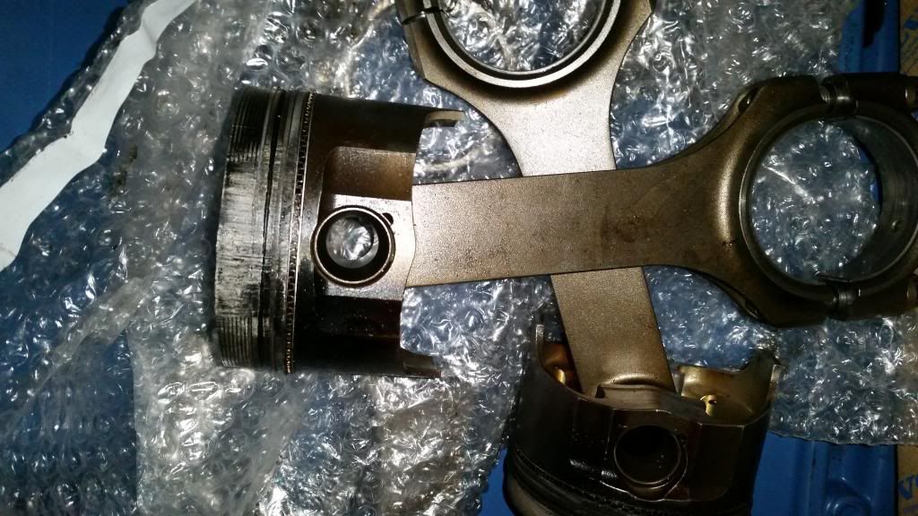

I completely melted down my fully built 7m 3 years ago and its just been sitting since then. I pulled the motor last summer and took it to a machine shop and found out the pistons were melted and block was out of round.
Since the motor was already 0.040" over it was garbage. I always wanted a 2jz so what better time to do the swap then now? I've been saving money and trying to locate a 2jz for a while now. They are hard to come by around here, Winnipeg MB Canada. Finally i found my motor, it came in an odd package...

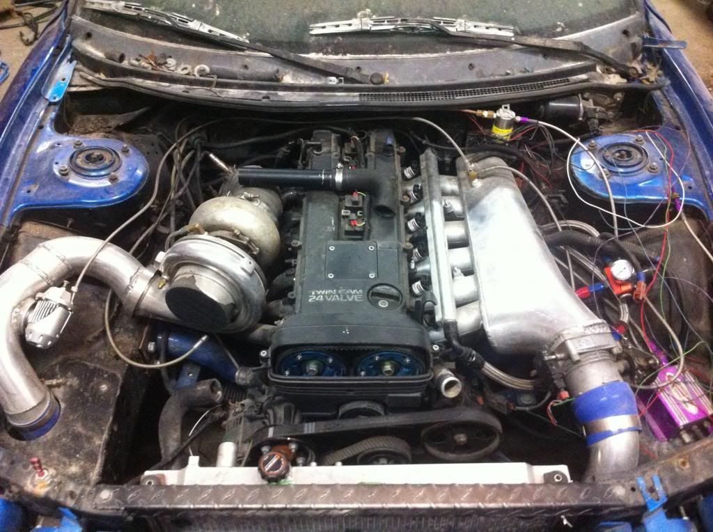

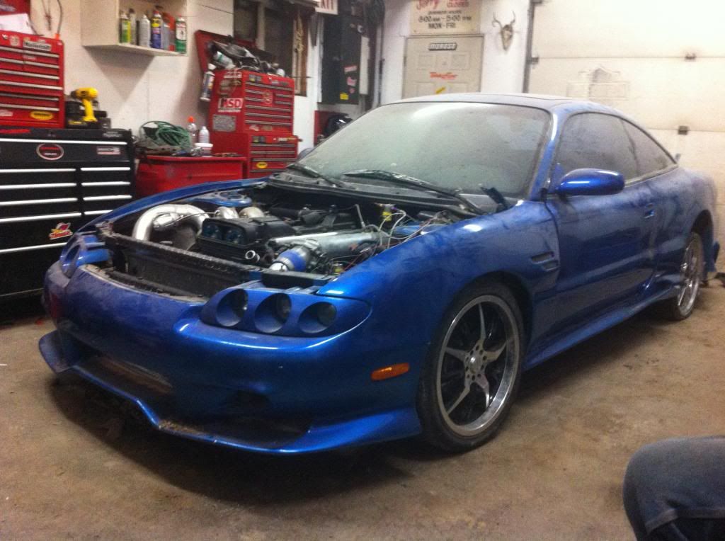

Yep your right, that's a mazda mx6 with a 2jz! The previous owner swapped in the motor and converted it to rwd using an mk3 irs. He never finished it and had it sitting for years. It came with lots of good parts and the price was right so i picked it up. its a rear sump 2jzge n/a-t with all the good stuff. 1jz flywheel and bellhousing, R154, Garrett Gt42 turbo, FFIM, full -10an fuel setup, 1000cc injectors, arp headstuds and TT HG, aeromotive a1000 pump and regulator, Aem ems, intercooler, bov, HKS 60mm wg. Zex nitrous kit. All kinds of stuff.

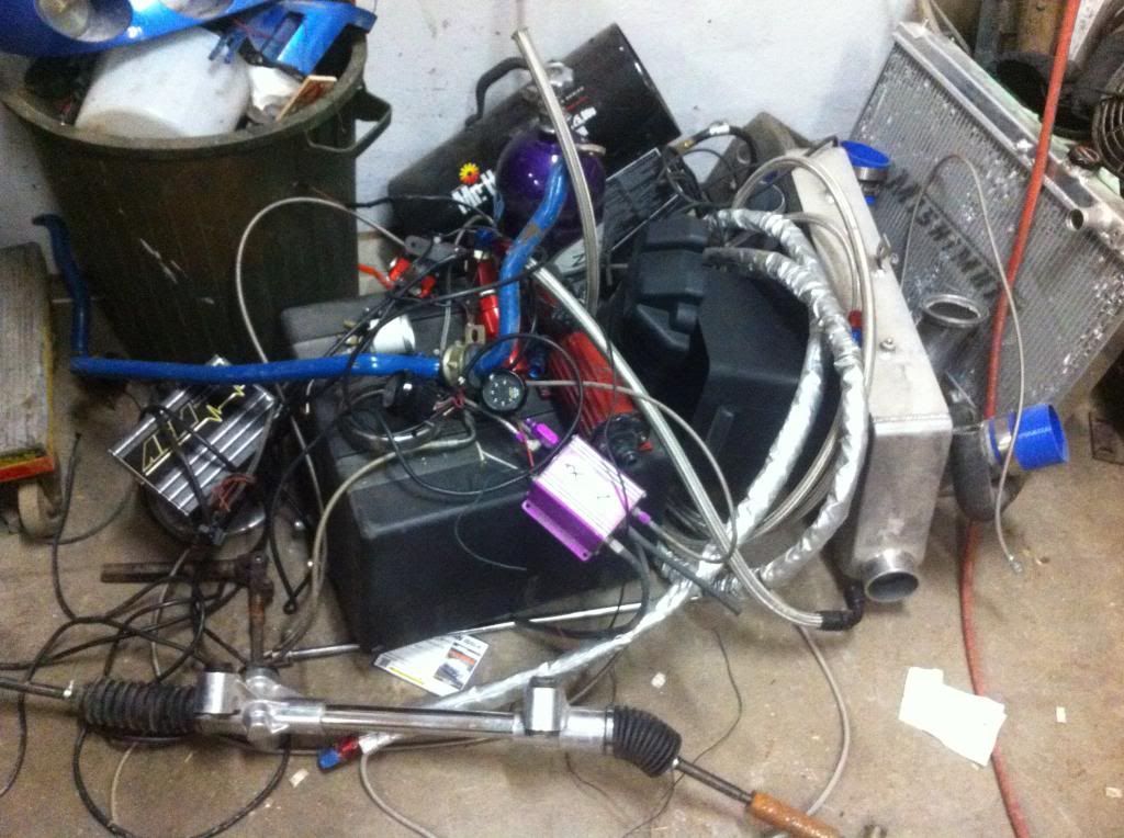

Quickly stripped everything out of the car

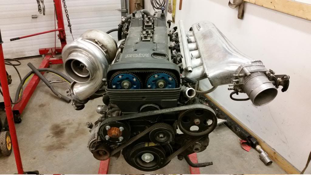

Pulled the motor and put it on the stand.

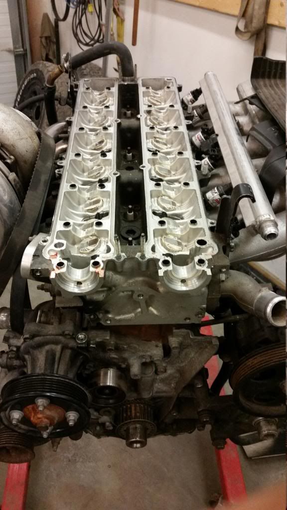

Since the quality of work on the whole car was pretty poor, i thought it would be a good idea to check over everything! Pulled out the cams and checked the head torque. It was very clean. Everything greased. ARP studs, all tight.

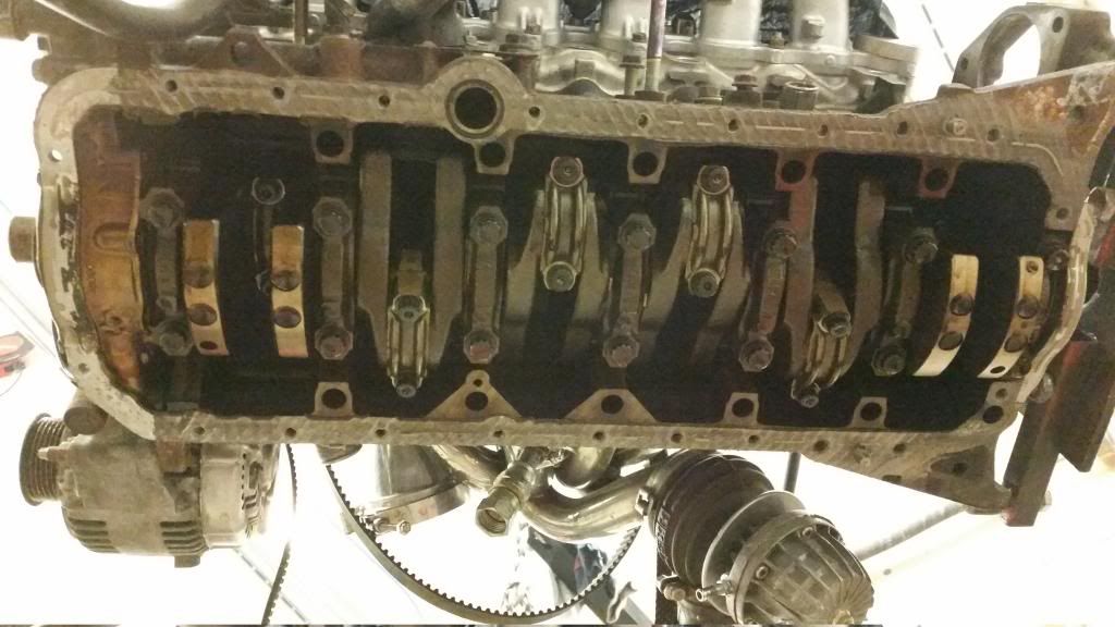

Pulled the pan of to check the main and rod bearings and torqued everything to spec. Everything looked good.
