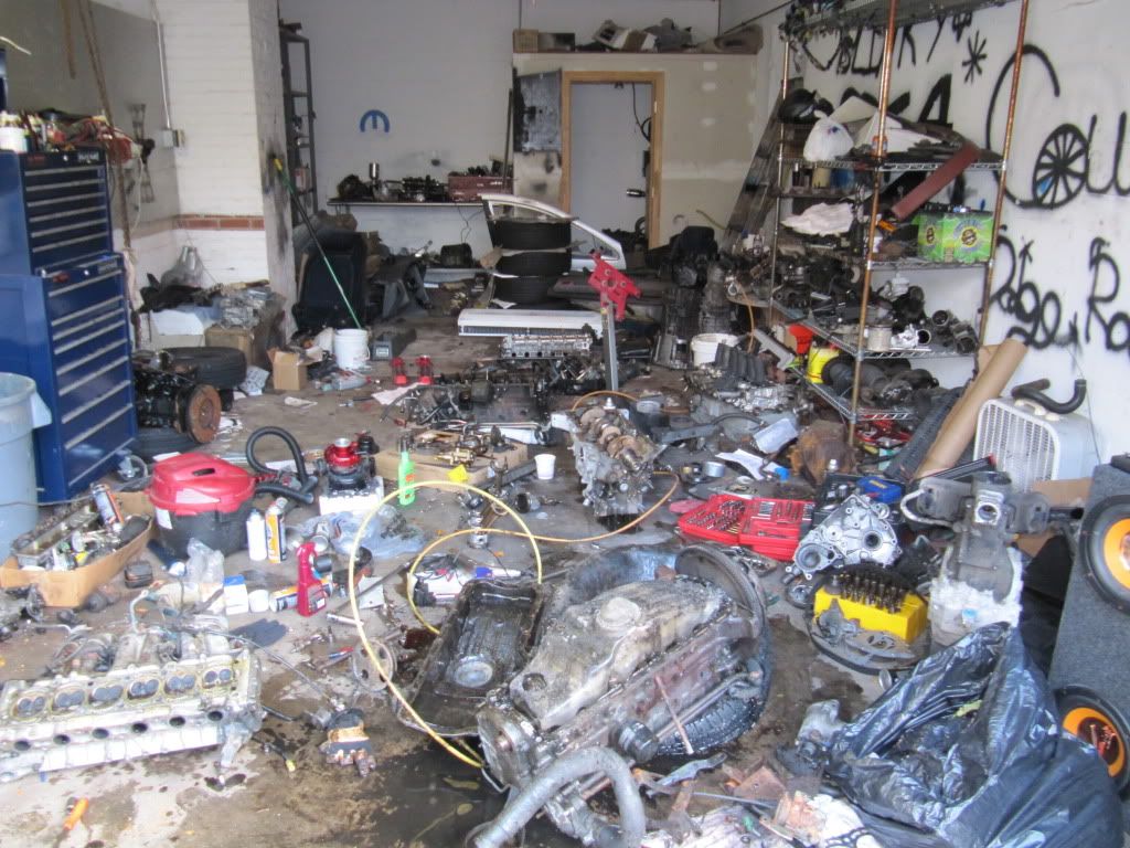

if u wanna call this progress... finding good parts to put a engine together.... working around this clusterfuck of a garage....
how many 7m blocks, heads, and tranny's do you spot? winner will get a cookie!
