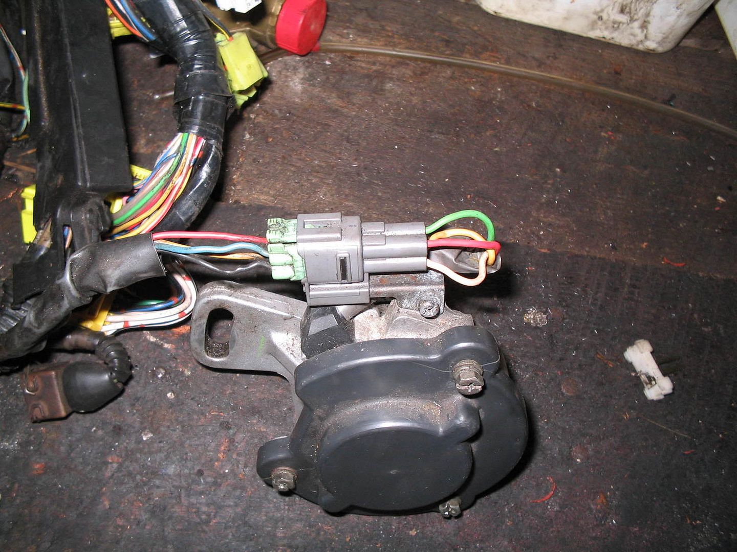

I just got an 89 jdm 7mgte and im in the process of swapping it. My car is an 88 turbo w /Auto trans. My problem is on my old motor the cps is hardwired to the harness and missing the clip i just need to know what colors go to what on the new cps??? The wires are completely different colors please help.
I would use my old cps but its not in the best shape

What color are your harness side wires? I'm in the process of wiring my cps and can't figure out the 2 wires(were the bottom ones). I'm thinking maybe i have a JDM harness. On harness side I have dark orange color, red and 2 black. CPS side I have red, green, white, yellow.

Thanks a million that was the picture i needed I think i have it figured out now. im hopefully going to drop the engine in tomarrow night and ill let everyone know how it went
