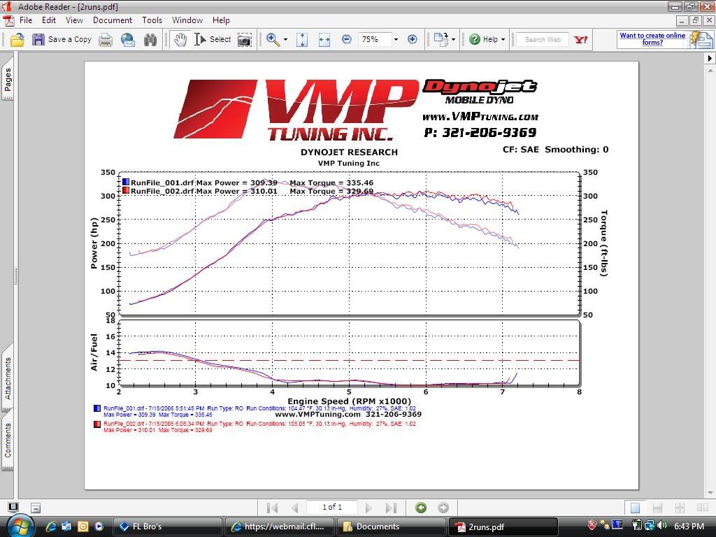

My car, stock twins, stock fuel, stock side mount, auto tranny. Wastegates shut, 20+psi.
