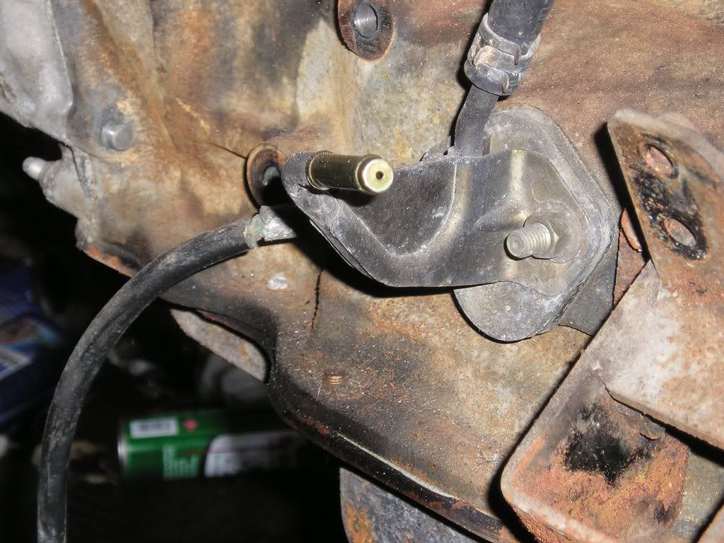

the j tube is there incase the stock fuel pressure regulator craps out. the restriciton in the j tube will cause enough backpressure to maintaing fuel pressure so you could limp home. with high flow pumps, the restriction is TOO much, and causes fuel pressure issues. (ie: too much pressure= running really rich)

one end is fully open, the other end has like a pin-hole opening - that is the restriction for backpressure.
Do a search on J-tube and you'll get some shots I'm sure, I just saw one recently...

here's a good shot. see the tiny hole? that's the restriction-
edit: YES, it's a HUGE pic!
