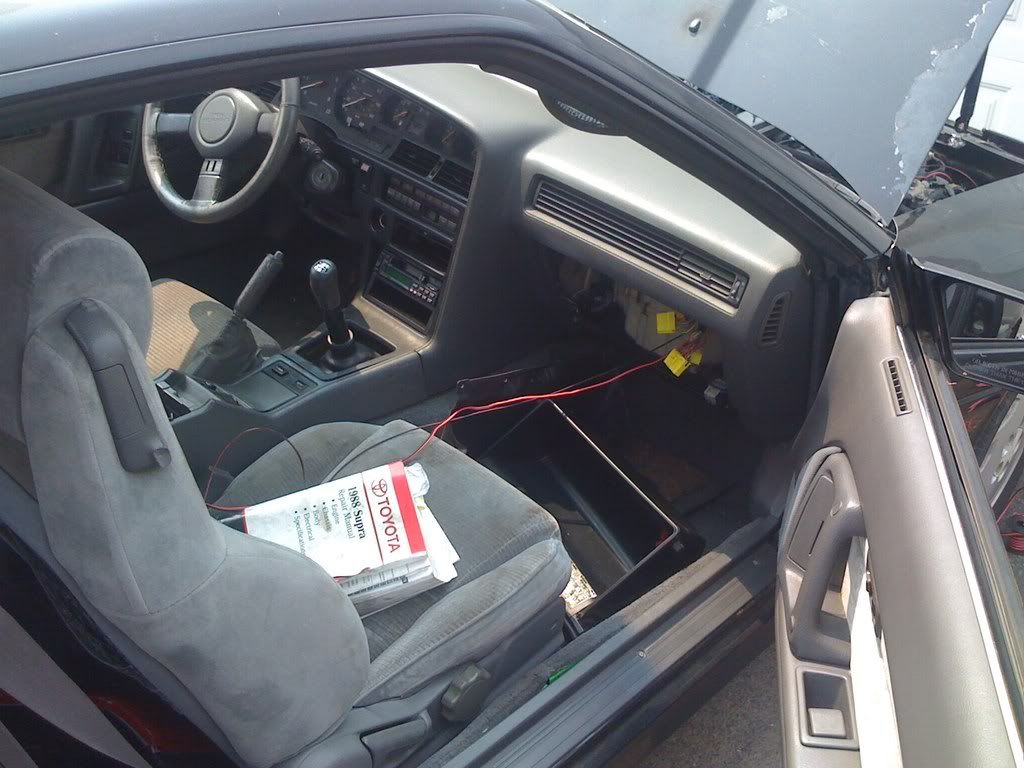

My roomate came running down the steps as i was making a sandwich and yelling there was smoke coming from my engine bay. I looked out not all that worried when i realized there wasn't just a little smoke but lots including large flames :aigo:. I couldn't get the hood to release and the fire dept. couldn't pry the hood open so they had to use the jaws of life :icon_mad:
As you can see the interior is nearly perfect. All electronics should be in working order...of course they can't though since half the system is burned up.

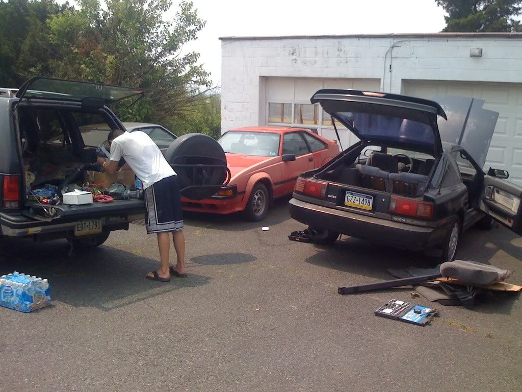

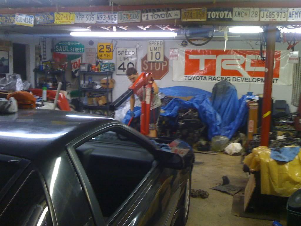

After a two day trip i got the car home from WVU on a trailer. Its currently at Gaboonviper's old boss' machine shop waiting to be parted.
Here are a few shots on the trailer (i took full adbantage of the "breather holes" the fire dept decided to add to the hood for tieing it down properly):

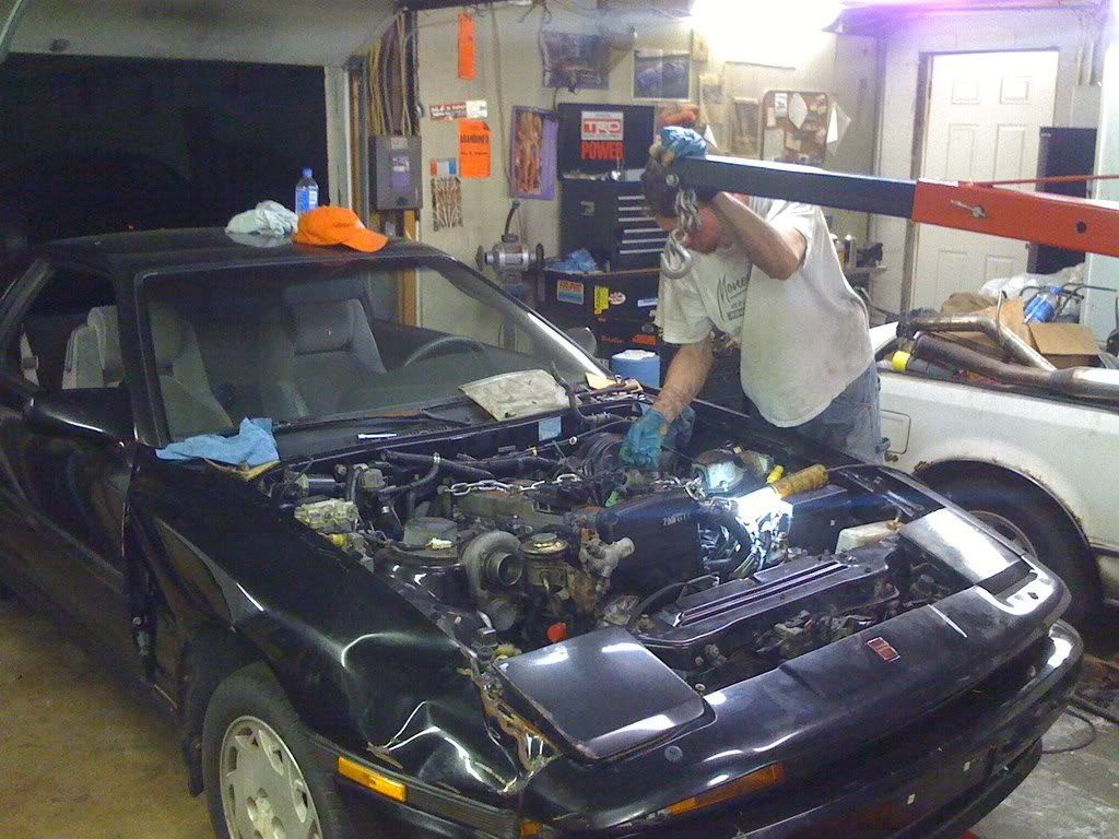

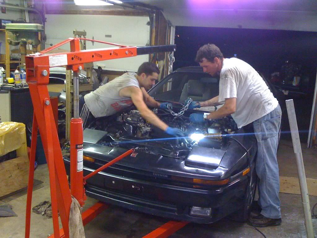

Days 3-5: The teardown
Gaboonviper and I have been prepping the car the past couple days to strip it of the engine/tranny and LSD. Today finally we got the engine and tranny pulled at least
Prepping:
picture.php
More Prepping
picture.php
Poor hood....you were nice once :3d_frown:
picture.php
Almost ready:
picture.php
Strapping it all up, Tyler trying to loosen the last engine mount nut
picture.php

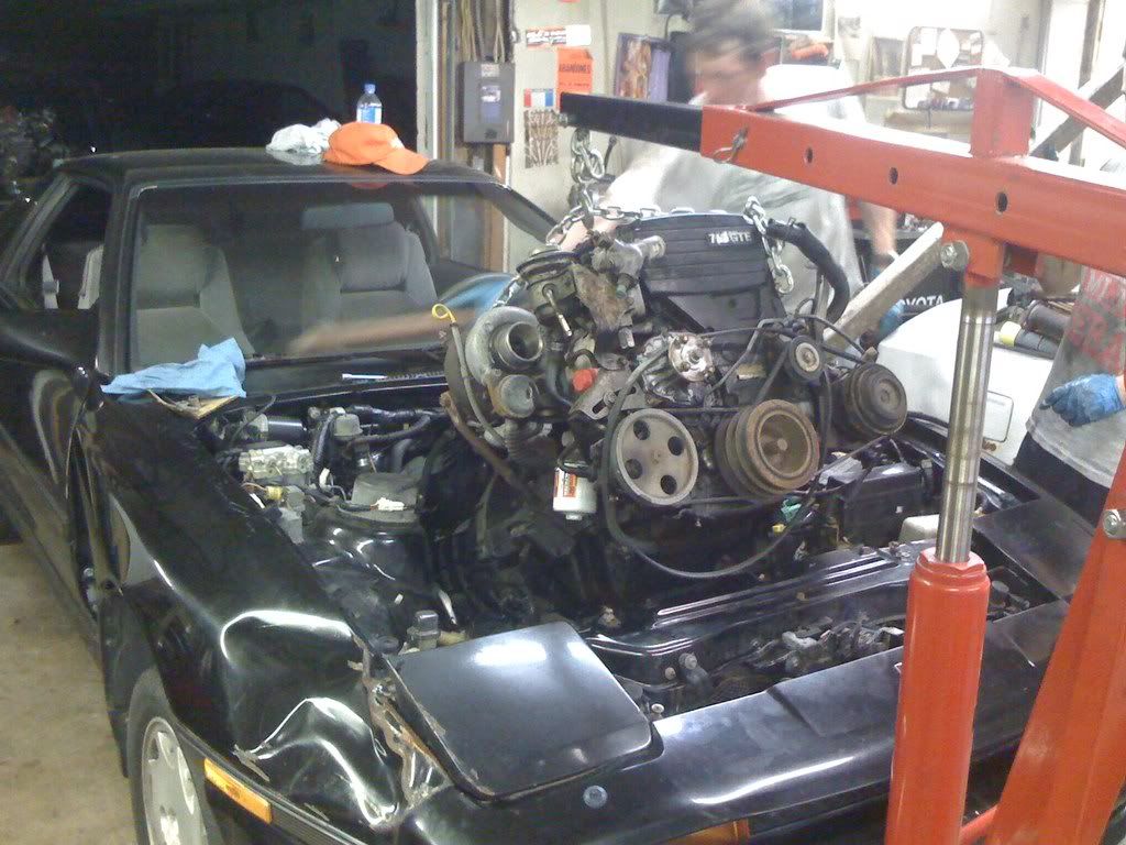

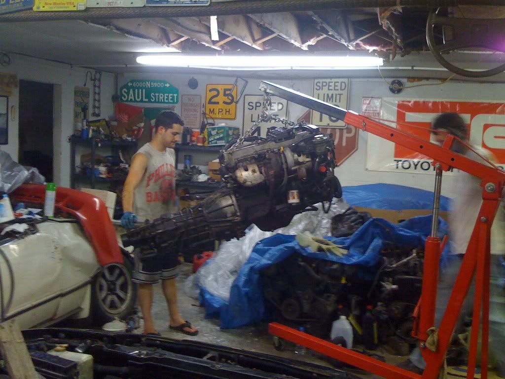

With some extra help and breaking a few more parts, out she comes:
picture.php

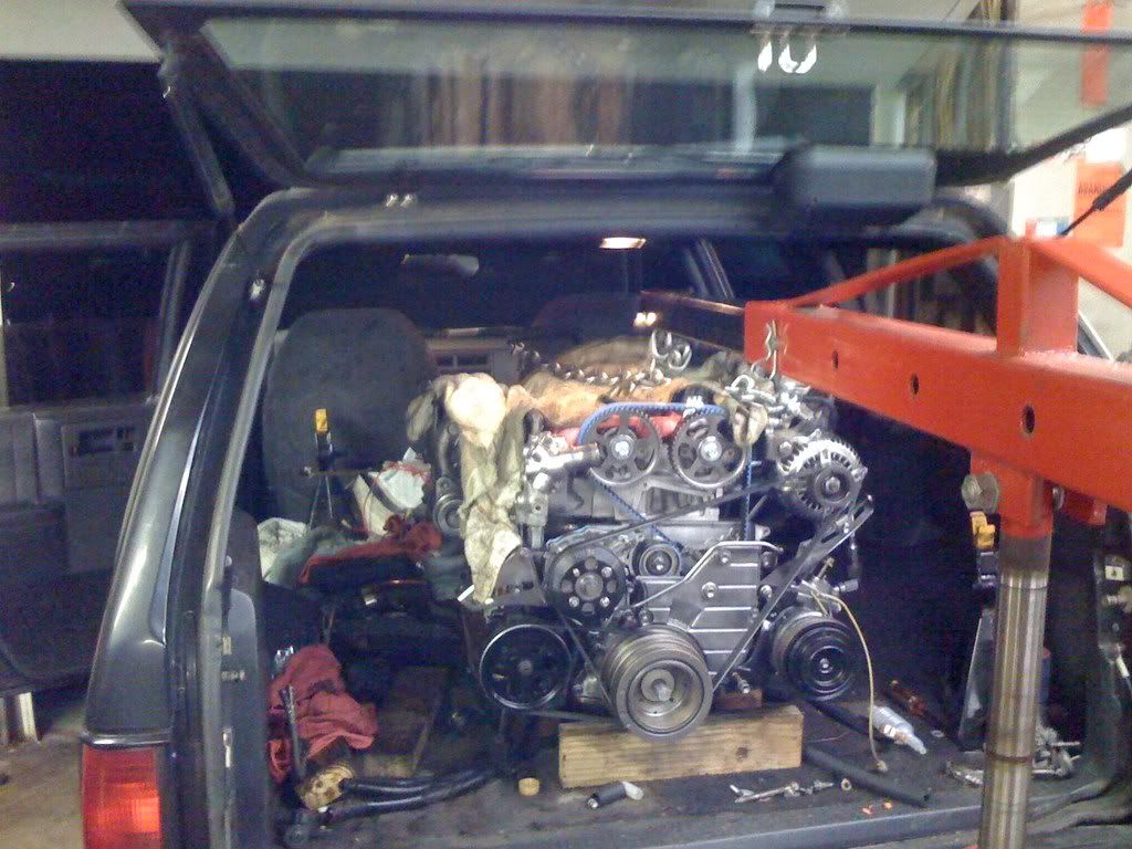

Open heart surgury almost complete (sorry supra, you don't get a replacement)
picture.php
picture.php

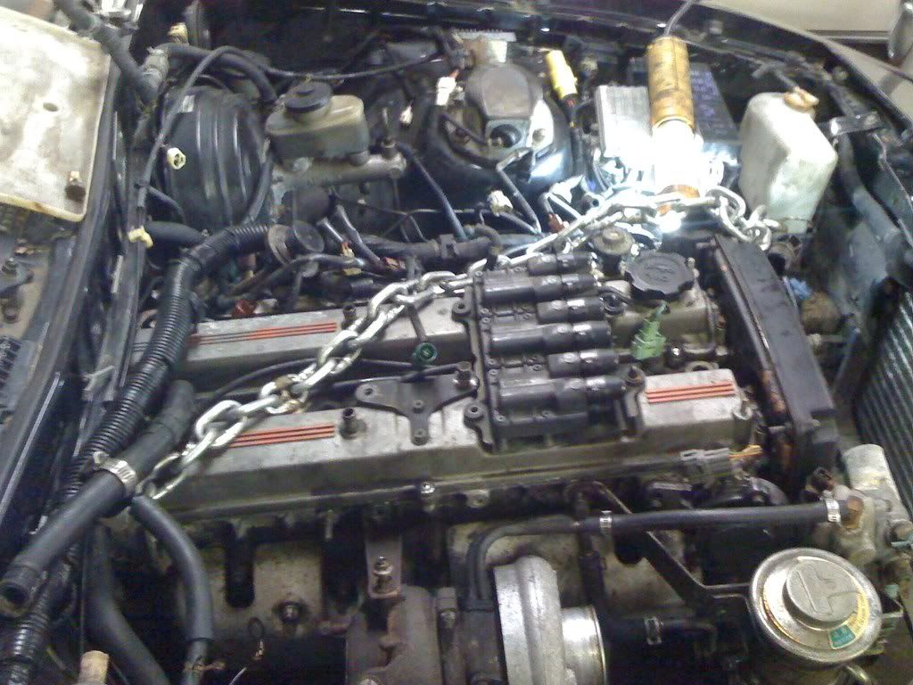

intake off:
picture.php

UH OH...whats this about??? Fracturing...don't know if its new or old?
picture.php
picture.php

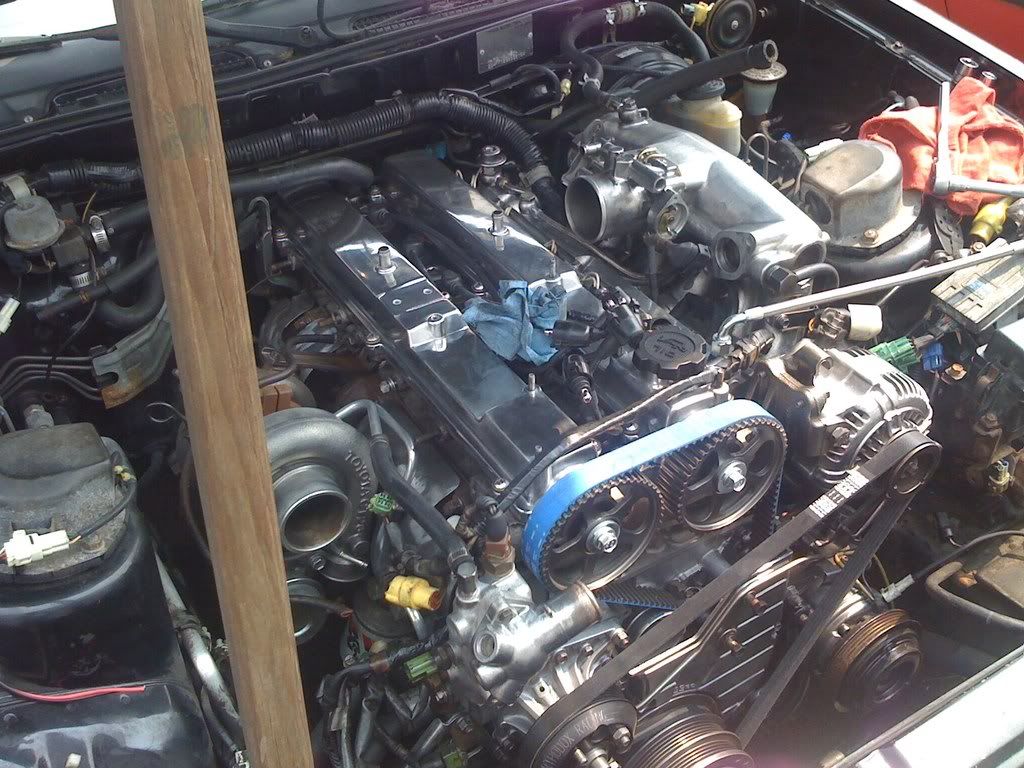

Head unwrapped, notice the burnt oil from the CPS getting so hot:
Valve cover and Fuel Rail:

***************************************************************Update 6/28/08
Running and well except my unstable AFR's. Im lacking an o2 sensor right now which is the issue. Excuse the crappy quality
