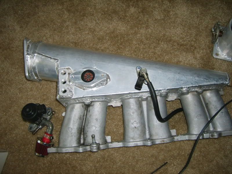

I have the CSI right between 3&4. Im hoping the "spray pattern" is wide on the CSI.
Here is a pic. of the under side of my FFIM from my build thread.
I had to order a new, longer, braided S.S. hose from driftmotion. 13.25" center to center;)
