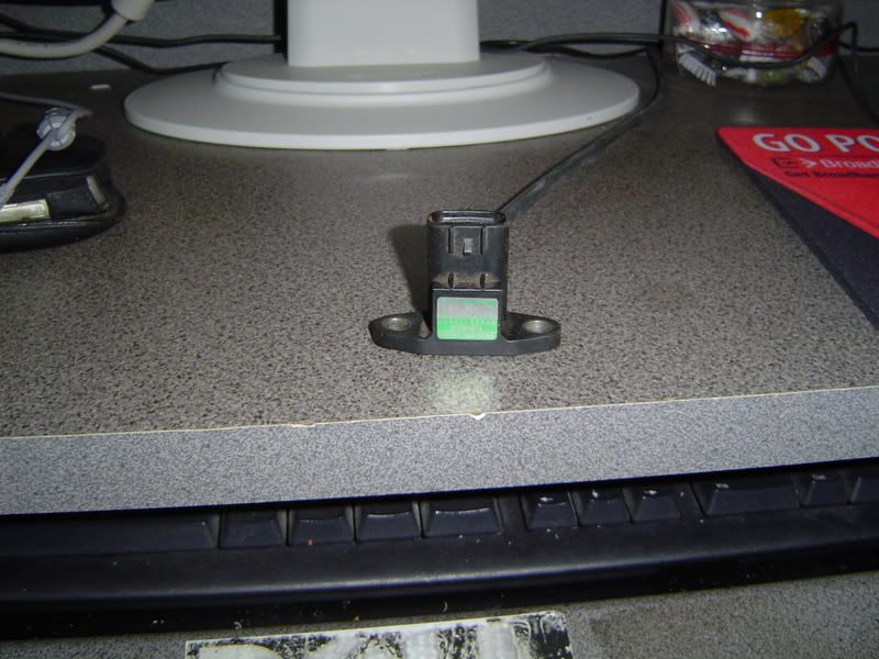

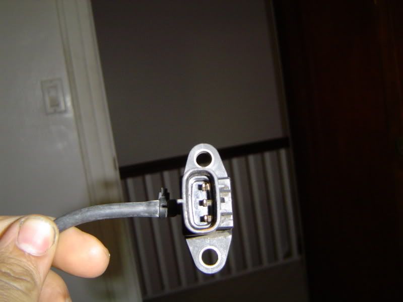

Is this a JDM 2JZ MAP Sensor?
crazysupra2JZ
Nov 16, 2006
740
Georgia
does it match this one
HIDPLANET
89 1JZGTE

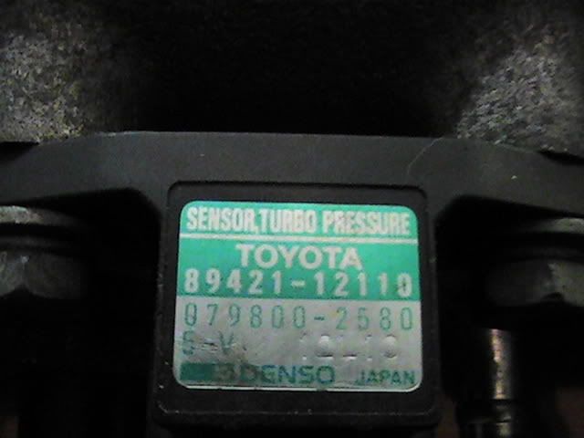

The seller responded with the following:
The label on the sensor reads-
sensor turbo pressure
toyota
89421-12111
079800-3060
5v
--DENSO japan
So since the part number differs does this mean it is not a JDM 2JZ MAP?
