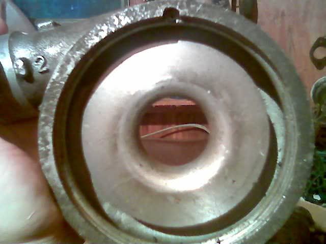

Supraboy89
Oct 25, 2006
357
Hampton GA
here u go
