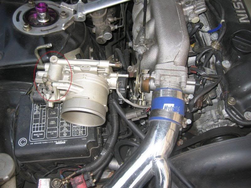

did you calibrate the TPS when the engine was warm, or cold? Do you have the coolant lines hooked up to the TB? The reason I ask is that, when the throttle body is sitting at ambient conditions, a thermostat-like actuator keeps the throttle plate open a tad. When the engine warms up, the throttle plate closes. If you calibrated the TPS when the TB was cold, your IDL will remain closed when the throttle is opened slightly at operating temperature. Slightly opening the throttle plate at operating temperature (when the actuator allows for complete closing of the throttle plate) will essentially mimic full closure of the TB at ambient temperature. Hopefully that made sense.

jetjock;984177 said:
I have no idea where you got that information but there there is no such thing.
that was an oversimplification. The thermostat/actuator (circled in the picture) pushes the throttle plate closed when operating temperature is reached (I assume...as it is connected to the coolant lines). If you have a q45 tb at hand, it is pretty obvious how it works.
I second that. The Q45 TB has such a thing. Of course, that is assuming that you havent disabled it by pulling the arm that it actuates off of the TB.
I removed mine because I didnt plan on running the coolant through the throttle body, and I didnt want ambient temperatures and heat soak to change my idle characteristics.
