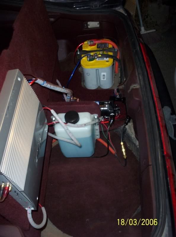

Run the small battery up front so you have room for your IC piping, Run your ecu/main harness power to that.
Then run a 2ndary for your sub/music / acc. but have it tied down in your spare tire well or hatch.
Run a higher output ALT for the two batteries.

i didnt really want to relocate my battery either, but it turned out to be a must. First they made the pipe with the battery inplace, but when it came time to bolt up the AC lines..the IC pipe didnt fit. So we ended up having to relocate the battery to the trunk. oh well.

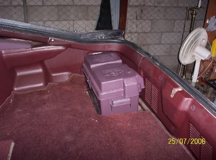

I think the easy way is buy a battery relocation kit for $69.95 at summit
SUM-G1200A.:icon_bigg

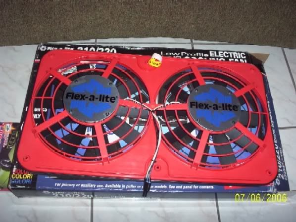

Also a bought This flex alite, but here in the summer at 115F with the AC on, can't cool the engine like the fan clutch.
I will install a Q45 TB, and the IC need to be of 3", so will be almost imposible to keep the battery in front.

I think that'll be your best bet.
Wouldn't be hard, btw, to make a fiberglass (or aluminum) replica of the stock shroud, with the A/C side modified for the thinner fans. Not hard, but probably pretty time consuming :)
