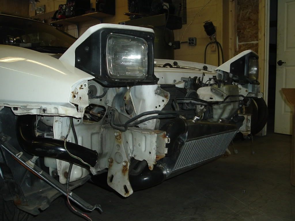

Agree with PWR and so do many many top level road race teams. If you change your mind and want something cheaper that you will probably have to modify to fit, my Mishimoto has worked out pretty well for me. It's a good setup for the price, and it's huge. I've changed the rad cap (it failed) on it and notched the rad supports to fit it.

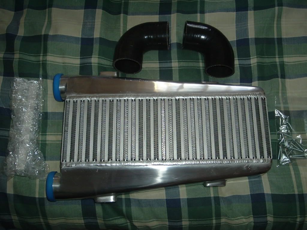

for the intercooler im using a spearco replica works fine and didnt have to move anything only thing needed were mounting brackets which it came with some
driftmotion has a nice kit for sale also
as for radiator sounds like your looking for one thats aluminum, i just went with a koyo oem replacement but if i was to do it again i would go with a pwr
