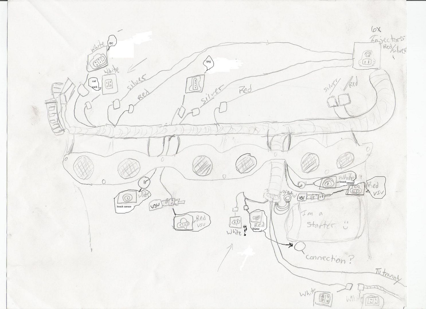

so i am reconnecting everything..seem to have forgotten 3...so i drew a picture
they are all color coaded and have pictures of their connections.
i have 3 question marks 2 under and 1 over the lower intake.
the red one under the intake with the question mark i think is a single connector to the starter somewhere.
hope this is understandable..if you can help me with those 3 connections there will finally be a diagram for this..at least that i know of i cant find one.

As lagged pointed out the post on the starter connets to a large wire that runs from the battery.
I think the red one goes onto the starter relay I dont rember the color of the connection but the connector looks right
I think the white one connects to a wire from the transmission, I think it is for the clutch safty switch ( If this car is a 5 speed)

it already has that one white connection to the transmission..i only remember 2 connections going down there
the white one is a short wire and the red is longer

just FYI thats not the clutch safety switch, its for the reverse lights. (the clutch switch is at the clutch pedal)

i was watching the vid on street fire of this BHG supra and it shows his block after the heads taken off and i saw there was a white connector on the top of the block in between #5 and #6 cylinder.
what is that? i think i found what that white one is

your drawing isnt setting off any alarms in my head, sorry. if you can snap some pictures ill be able to let you know what it is immediatly.

well i found out where 2 outta 3 of them are
top white clip is for the coil pack
the bottom red one is connected to my starter.
i still cant figure out where the white one goes..
