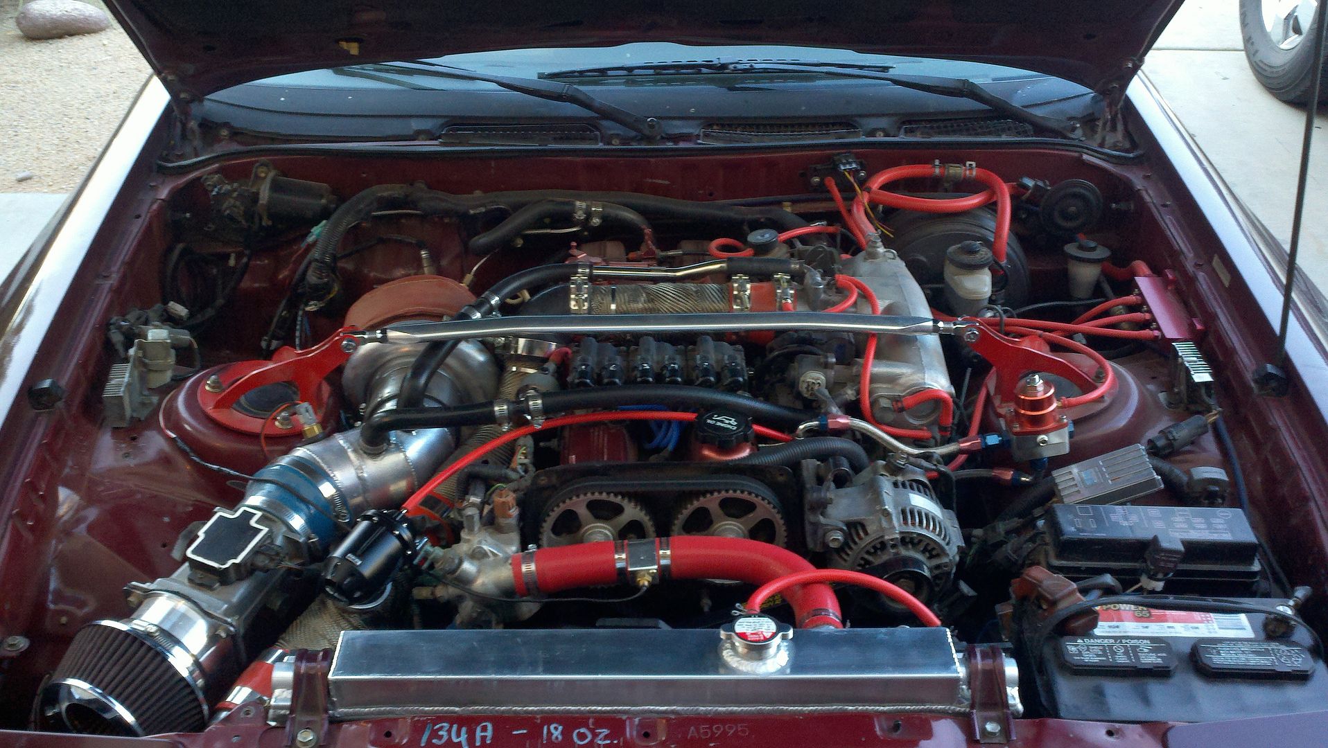

Gotcha. That would suck being so close to the heat. Because of the way my turbo sits high, I had to custom route my cold pipe the way you see it (couldn't go over the turbo like a CT-26, so it runs right over my header). I also header wrapped it to cut down on the internal temp of it. So far, so good.
