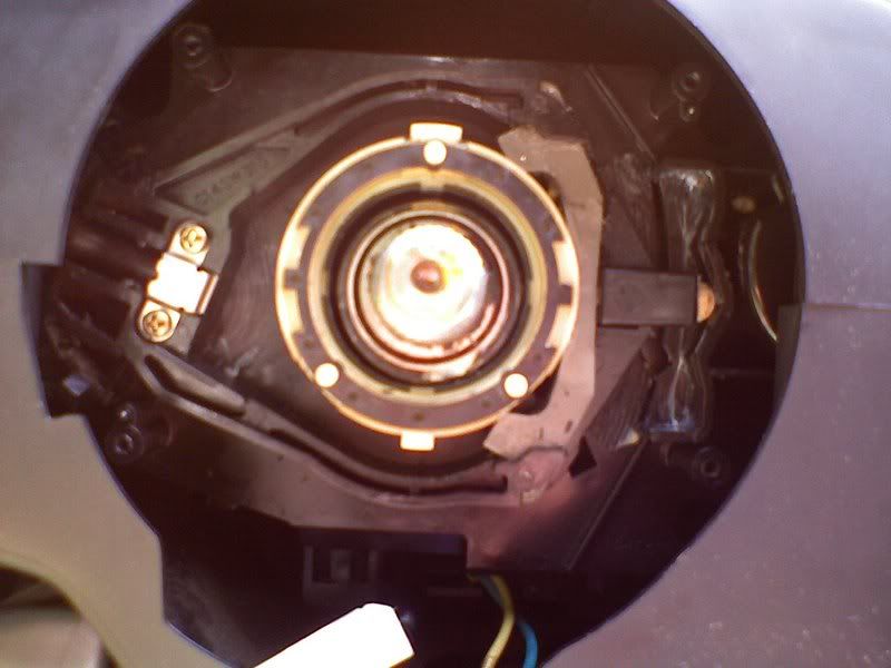

Anyway this is how my column looks like, I know the non air-bag models have a metal contact plate around the clock spring.

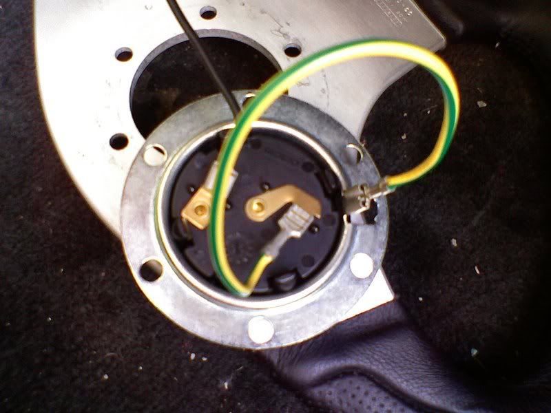

This is how my horn button and metal retainer are hooked up. Is it hooked up the right way?

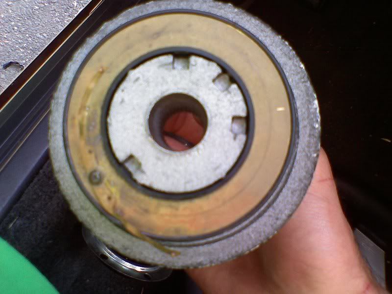

This is how the back of my hub looks like.
