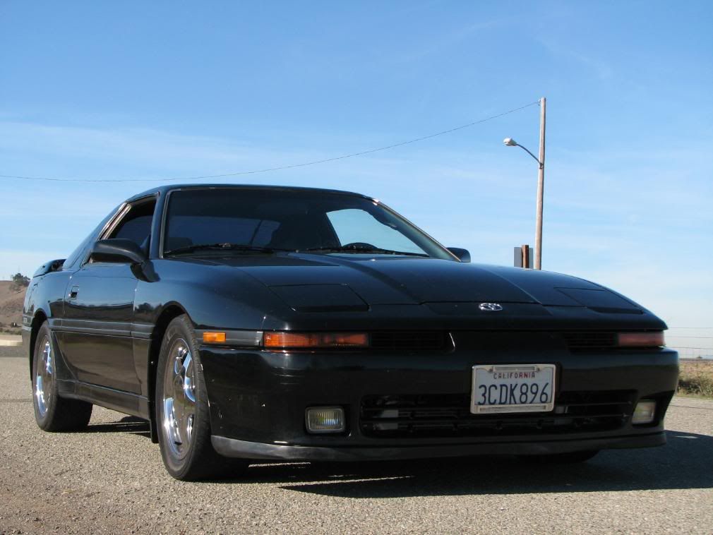

I love mine. The stiffness and ride heigt is a lot better than the Stockers for sure. With 16 inch wheels, it still sits with a lot less space between the fender wells and the tires. Ride is quite good as well. I like it a lot better than Eibachs I had before.

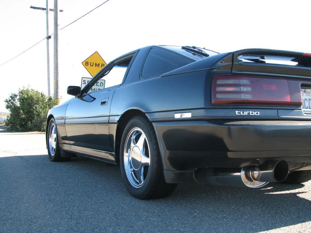

Here is one with 17 " wheels :

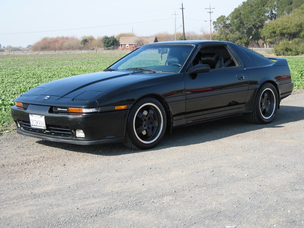

Here's mine with MKIII 5-spokes:

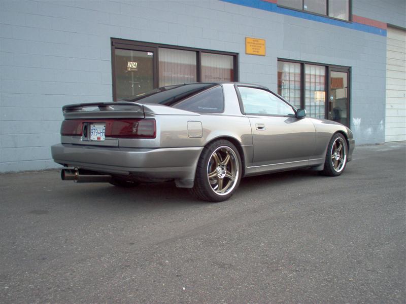

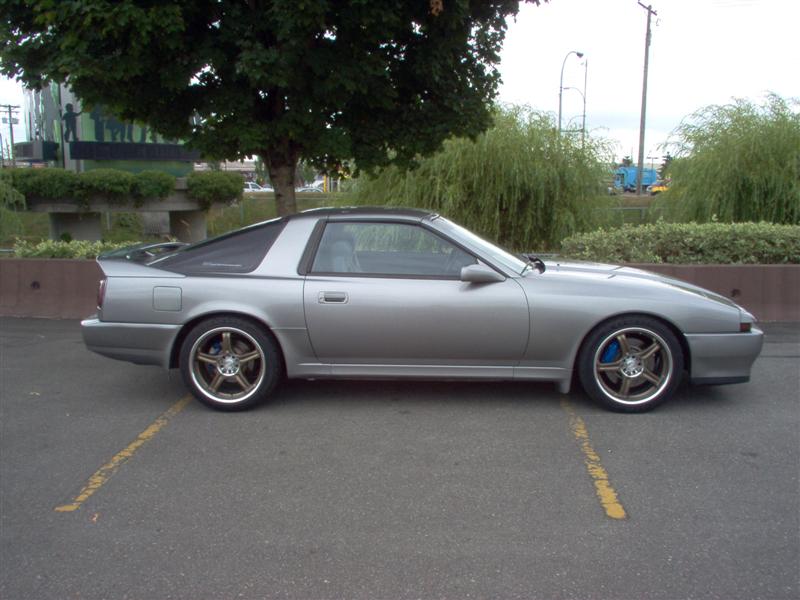

I have the TTR springs and struts (bilstiens) on my car. I think they have the perfect ride. It is stiffer than stock, but not as stiff and bouncy as coil overs. The height is about 1.5" lower in the front than stock and about 1" lower in the rear. With 18" wheels and 235/40 tires on the front it sits perfectly. The rear was a little to high for me, with a raked look, so I cut half a coil off to make the rear sit level.
I had Eibach springs before with KYB struts, and the TTRs ride way better, I feel the Eibachs are to soft. The drop is about the same as Eibachs, within 1/4- 1/2" that i measured. I have done some auto crossing and lots of high speed driving and love the suspension setup.
