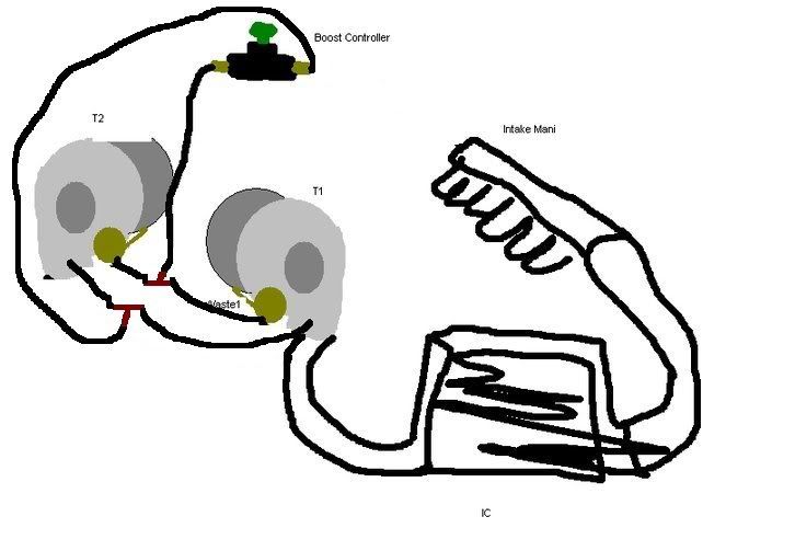

Yeah i would kill for the possibility to up boost but for some unknown reason my 1jz wont except a boost controller.....:3d_frown:
Now before the "you hooked it up wrong" comes to play, check out my previous thread...
http://www.supramania.com/forums/showthread.php?t=64399
how i did it...

If you are using a pressure regulator (?psi) it will not work with the type of waste gate the twins have. Use the spring plunger type regulator which holds the pressure at desire setting as the other regulator uses vacuum and open pressure. Any pics of that regulator?
