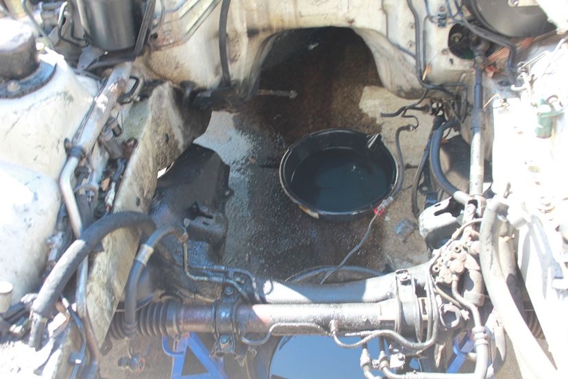

All the oil on the ground came out of the inter-cooler. I was so surprised, I wasn't expecting oil to come out I didn't have the pan ready.
Oil cooler, PS Fluid Cooler, Inter-cooler, Radiator, Condenser...this thing is all about the cooling.

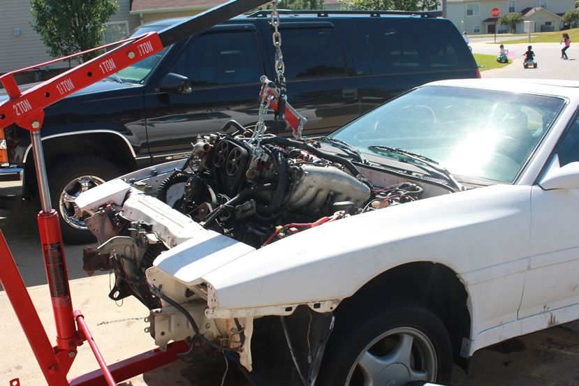

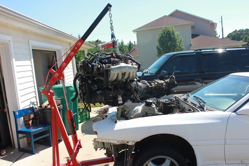

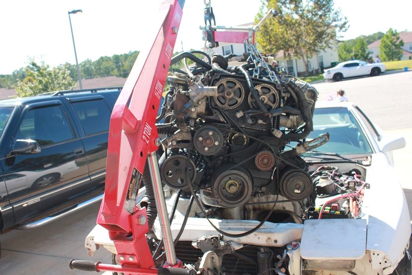

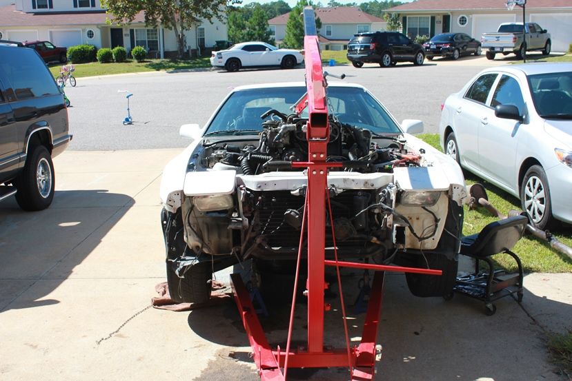

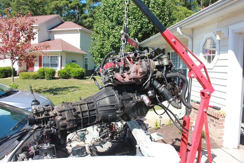

I only spent a few hours on sunday working on it. I spent most of the day with the family. As much as I want to work on the car all the time. My family is a priority, I mean I did just get home from Afghanistan two weeks ago. So anyway, after the work I did on Saturday, it was already practically ready to come out. So I hooked up the lift and unbolted the engine mounts. Then it only took me a few minutes to unbolt the small things that were still attached. The fuel lines, a ground cable, the main battery cable to the starter, and the ac hoses. I can't believe I forgot a few of those...lmao
So yeah I started the lifting and unbolted everything...

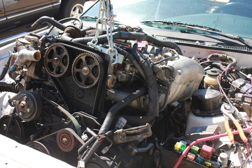

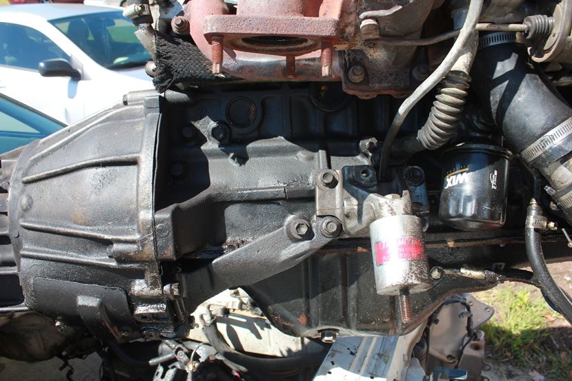

If you look on there you can see how I bolted the lift point to the block at the alternator bracket hole.
And the other side on one of the manifold bolts.

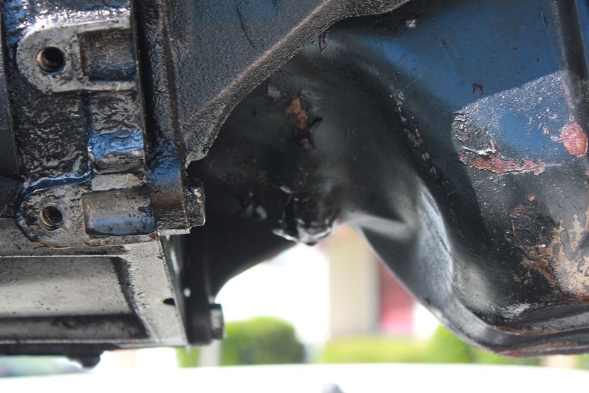

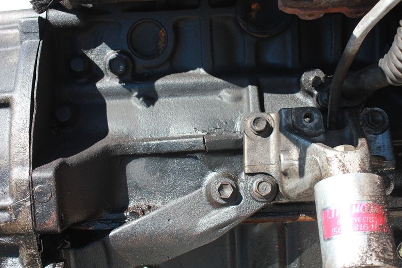

When the PO rebuilt the motor he must have removed the lifting hooks, so I had to improvise. I was kinda worried at first but it turned out to work okay. So I hooked it up and lifted.

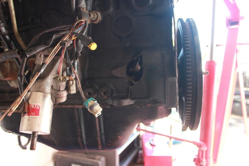

You can't really see it this far away but you will see the hole in a later picture.

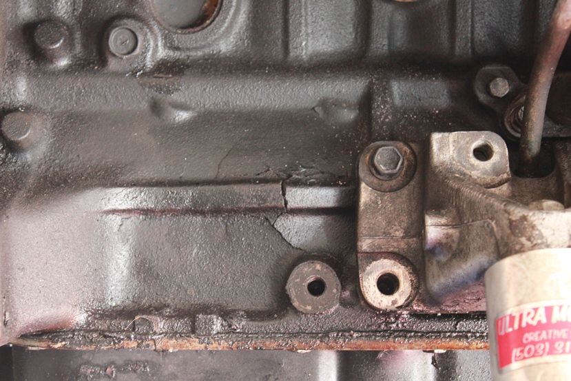

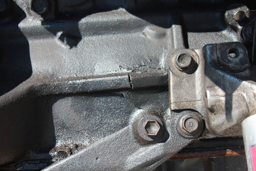

And the crack on this side.
There is a close up of the crack.

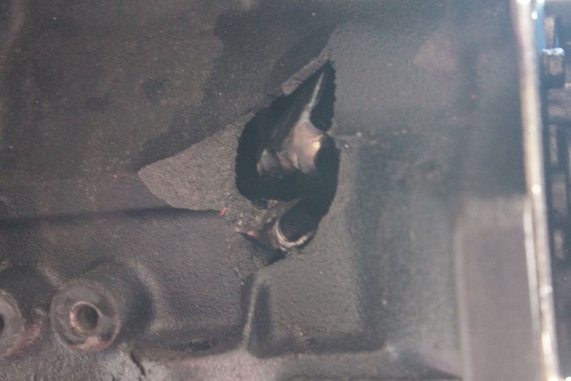

And the damage the spinning rod did to the oil pan.

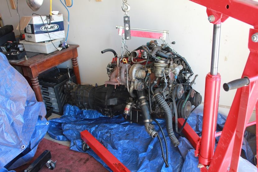

The engine in the garage.

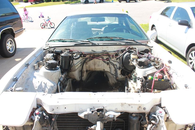

The engine bay is so empty. Of course I have more to take out, and then to clean it up, and I think I might even paint it before I throw the 1UZ in. What do you guys think?
Got the tranny disconnected. And by itself. I still have to take off the clutch and bellhousing to prep it for the new stuff once it gets here of course.
The bad engine all by its lonesome. I started taking it apart just to see the extent of the damage. It seems that the block is toast, but the head and everything above the block is good. I didn't pull the crank yet, but from what I can tell, the crank is still in good condition. So I am hoping to sell off everything from the engine that is still good.
So yeah, as you can see the block is done son. So I am probably going to take it to the scrap yard and see how much money I can get for a couple hundred pounds of iron. lmao...

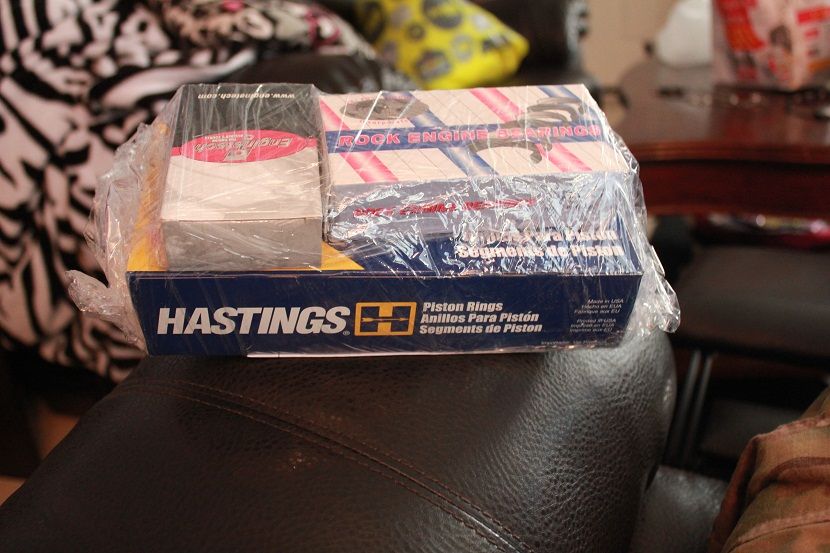

On to better things, I got yet another package in today, as I am sitting here writing this. Awesome. Like I said, packages are one of the best parts. So now I almost have everything I need to begin rebuilding the engine.

I would definitely paint the engine bay, you wouldn't want to complete the transplant and then decide it's what you would like to do. Take advantage of the motor being pulled and clean it up as much as you can, I know I would. Maybe try hide as many wires as possible on your way if that's the look your after, maybe relocate a few things to get a simple bare engine bay. Nice updates

I'd say go for it and paint it, think of re locating a few thinks like the fuse box and battery, parts like that. I removed everything to do with A/C in my supra and that made a big difference, got rid a some weight too not much but it's something

I actually have been looking into it, I think I am going to relocate as much of the wiring as possible. I want to move the battery to the rear somewhere, and stuff like that, the problem is that I need to have the engine up and running ASAP, so I can't do anything that will take too much time. So I will probably paint it and then throw everything back in...and then work on relocation of everything.
