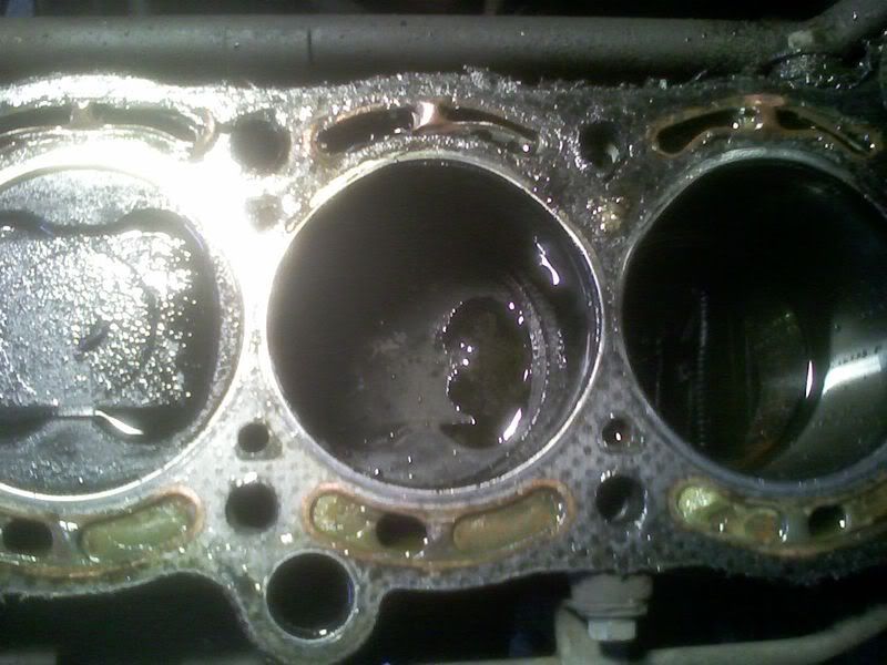

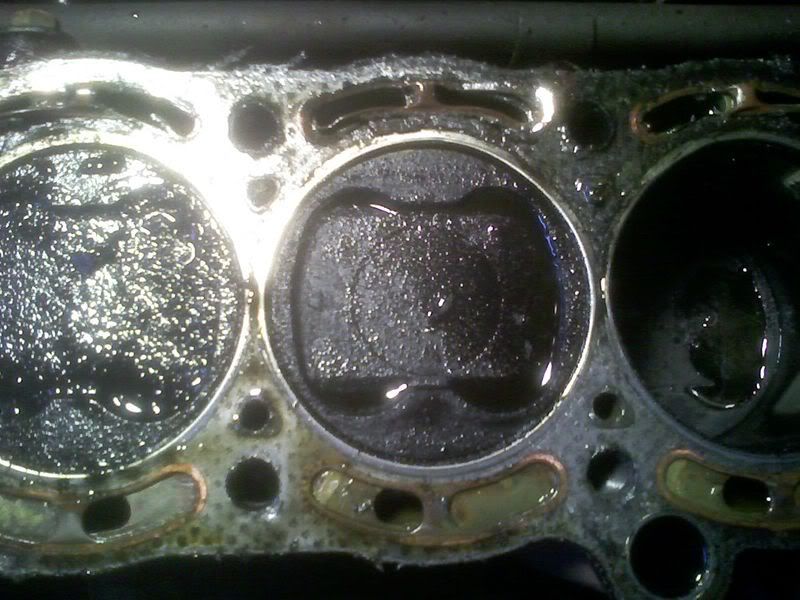

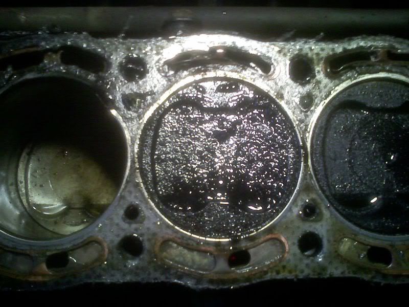

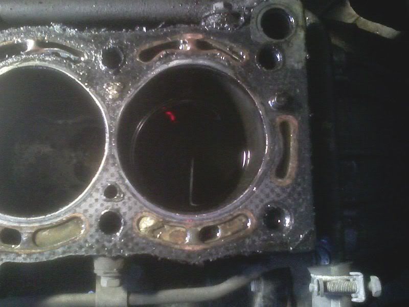

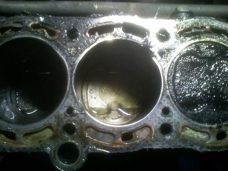

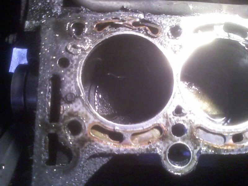

Pulled the head off on my days off, and it looks like someone before me pulled it off and had zero clue what they were doing. It looks like the head might have some damage will not know until i can clean it nice and good. As you can tell in the pics in post 11 the HG and is toast.

Sorry for the cell phone pics
AJ'S 88NA
Jul 26, 2007
2,419
Florida
You don't need high quality pics to see that damage. Your're going to have to take it all apart and check the bearings they have to be bad by the looks of your HG, looks to me like it's been going on for a while.
