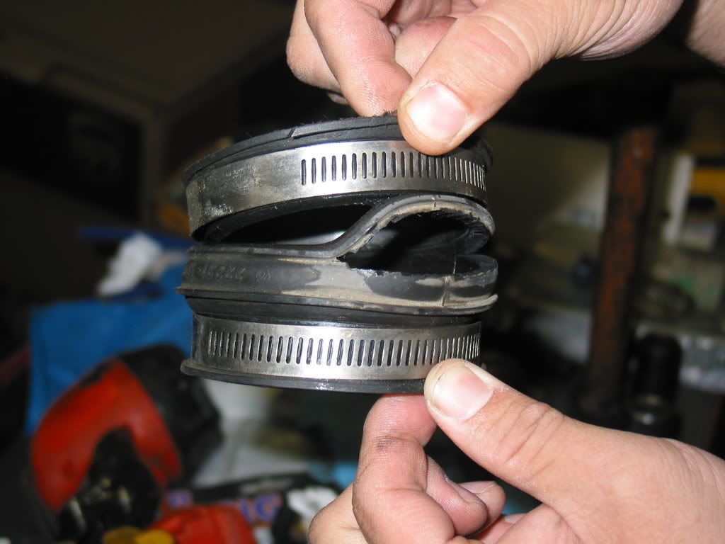

I think I found my Boost Leak...

If that one's broken I could imagine what the bottom one on the turbo looks like. :aigo:

Same thing happened to me at the track. All i had was duct tape, and it worked! made 1 more pass before i left the track, 1.6 sec 60 ft. aint bad for duct tape!

I had a drunk friend rip mine by accident :x electrical tape will not fix it, haha. I bought a silicone coupler the next day, just needed something to try and get the car running that night haha.

I remember when I had no idea how turbo's worked or what boost leaks were... I found the same one melted like yours.
I had gotten so used to how slow it became, thinking "I blew my turbo"... to "OMG this car is so fast!"
:rofl: @ ignorance.

LMAO! That's funny Brent. Anyone know off-hand what size that coupler is? Decided to change my plugs while I was down that far retorquing the head (BTW, I was shocked to find that they actually used ARP bolts on the thing...). Old plugs were HAMMERED! I'll post pics in a bit...
