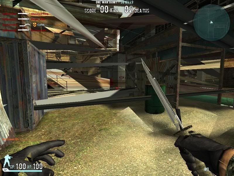

My nvidia card went out and started giving me terrible fragments and glitches in games, couldnt even play. It works fine for normal use but games just do not work. Ive tried multiple drivers nothing helps, i assume its just konked. I doubt it was a heat problem because i have a zalman copper big ass cooler on it.

Ive got an old 6600GT, im not sure when it started because i just recently started playing games after not playing for a long time, and it was doing it the first time i tried. It only does it on some games also. I have tried new drivers old drivers and in between, no luck. I overclocked it and that made it work for a while, and then it started doing the same thing even overclocked.
