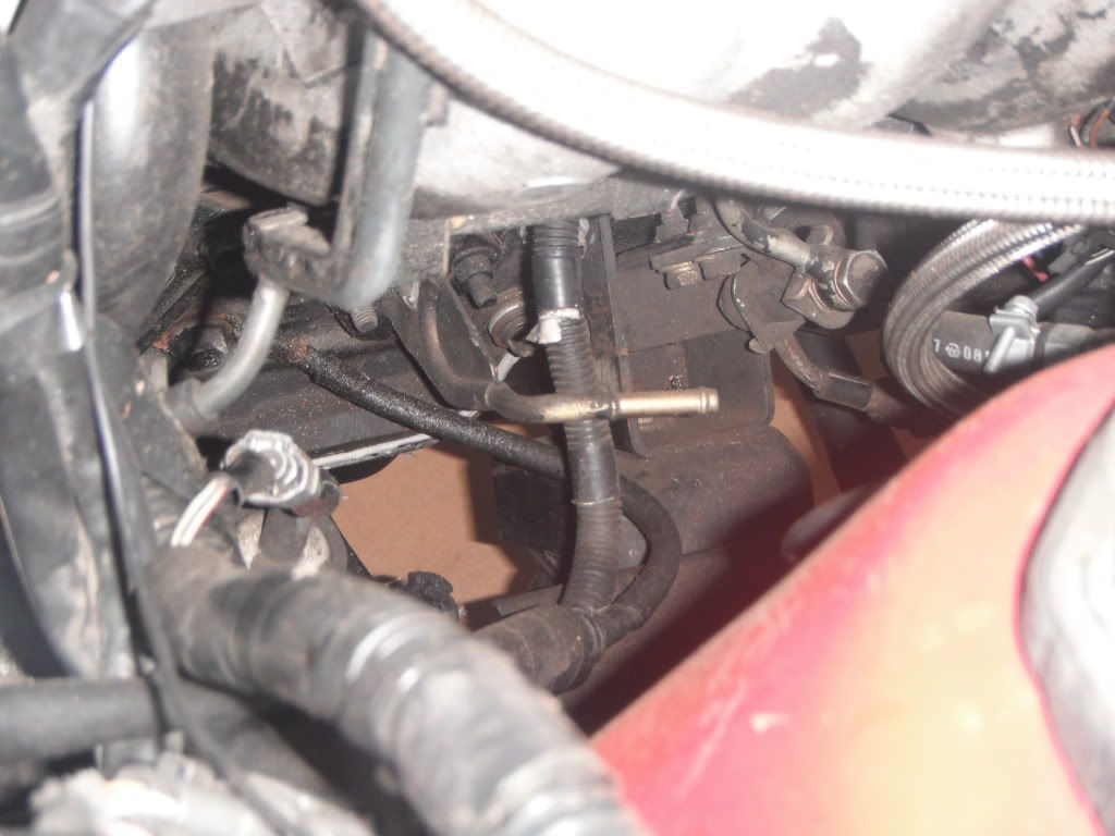

this picture I took at a slight distance, as I wanted to have the line in question put into context. it is the copper tipped line down in there...
it's underneath the intake manifold. It wasn't connected to anything, so I took a picture to put up here and see if it was supposed to be hooked up for anything important, or if it was just for the a/c or something.

he has 3 supras? and one that is running good...yet doesnt know what the PSR is? or that that is the main fuel line. not the return line. I think i saw an AFPR which is why nothing is going to that now

Correction ^ That is the return line, the J tube, Not the feed.. The feed is the line that the pulsation dampener goes onto, return is the fuel pressure regulator towards the front of the motor.
HOW DARE YOU QUESTION MY 7M KNOWLEDGE ;) jk bro Ive seen lots of people confuse the two lines (feed, and return)
and thank you Devin for seconding my knowledge
