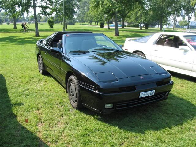

On my old black '89 I used VHT Nightshade, it worked great. I'm going to tint my tails a bit on my new car just haven't gotten around to doing it yet.
Here is a pic of my old car.
I just took them off the car, cleaned them up really good. Took some really fine grit sandpaper, and ran it over the lights a few times just to scuff them up a bit. Then just go slowly with the Nightshade and just add more layers till you've got them to how dark you want them. Then you can either just leave them or clearcoat them and polish them up so they are nice and shiny.

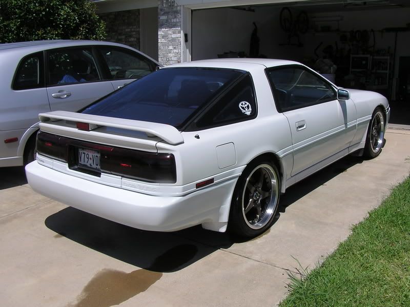

I have JDM tails, not really worth it IMO. They are darker than USDM ones, but not by a whole lot, in pictures you can't even really tell. If you want dark tail lights you might as well tint them. I will probably end up making mine darker.
