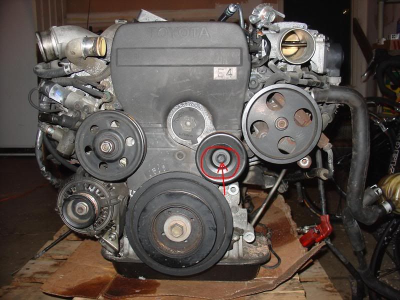

It's probly obvious but I'm replacing my Crankshaft pulley with the Fluidampr and I got everything out so now off comes belt than pulley, how do I de-tension it?
Thanx man I hope the pulley is not as much of a bitch to get off as my 7m crank pulley waswerewolves182 said:Put a 14mm wrench or socket on this (tensioner) and push down as if tightening it. That will release the tension on the serp. belt.
