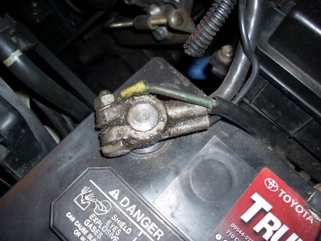

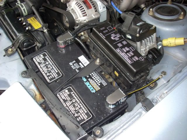

I just replaced my battery and terminals this last weekend. With my headlights, fogs and a/c running I was showing under 12V at idle and thought this would be a good start.
Old and busted…..
Neat clean and organized…..
The battery hold-down bar was pretty badly corroded so I gave it the once over with a wire brush and some leftover rattlecan. I trimmed off a little too much :nono: on the inner fender ground so that will be redone this weekend with a longer 4ga wire and terminal.
