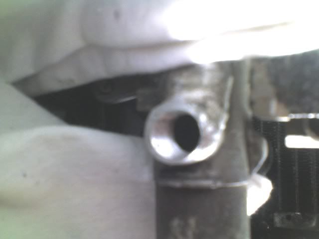

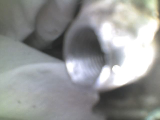

I was checking out an extra cover I had and looking at the port, the 7/16 drill bit I was going to use for the 1/4 npt fitting is basically the same size as the coolant outlet. I went to my engine and stuck my finger in where the hose comes out and felt inside and around the back of where it was welded to see if it was welded all the way through. To my surprise, at least 2/3 of the thread is still there; maybe more. The previous owner must have just glopped the weld on the top of the port. If I drill it out for a 1/4 npt fitting, I will only be able to tap the 1/8" of weld and that won't be enough to seal.
The question is, should I just go a size bigger, drill out the old thread and still use a NPT fitting? Or should I just take a file and grind down to the original threads and use them? I;m not sure I can get the surface smooth enough though. I really do want to use NPT, but if I go bigger, I'm not sure if the walls will be too thin at that point.

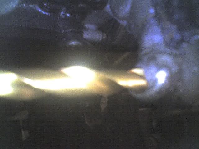

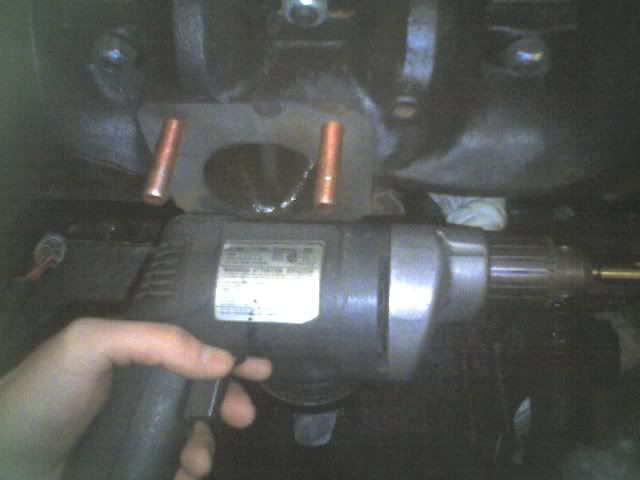

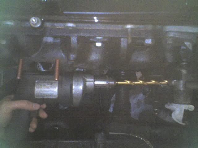

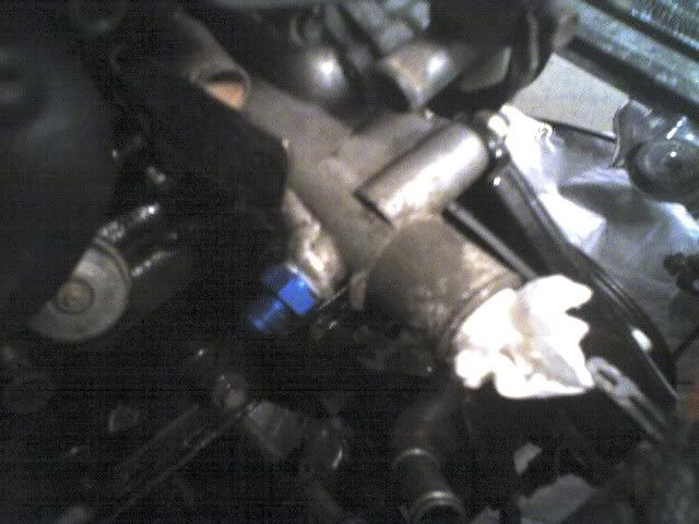

Done! And the best part is that I didn't even have to remove the water pump. I took some adhesive putty and thinned it to around 1/8" in my hand. Then I fed it through the side opening where the hose goes and pushed it over the back of the water port hole with my fingers. When I drilled and tapped, the putty stretched back and collected all shavings; they just stuck right to it. I removed the shaving filled putty and replaced it with new putty between each drilling and tapping. It worked fantastic! No metal shavings anywhere inside.
To start, I drilled a guide hole with a dremel before drilling the hole for 1/4 npt with a 7/16 bit which actually was pretty easy. I had just enough room for the drill with the removal of the turbo.
I only had to drill in maybe 1/3 of an inch before I exposed the original threads.

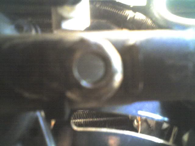

I took a flat file and made the surface as smooth as I could without taking too much off. I wanted as many threads as possible. Then I went to a 9/16 bit to make room for the 3/8 tap. This is where I had problems. I guess I should have went 1/2" bit first since the 9/16 kept jamming and going all over the place. Made a real mess. Used plenty of lubricant, but it just wasn't helping. Luckily, I was able to keep the hole relatively straight. I used a wrench on the 3/8 NPT tap and it went in real smooth using plenty of lubricating oil. It threaded at sort of an upward angle, but it should be fine.

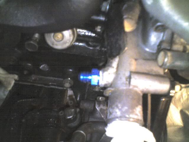

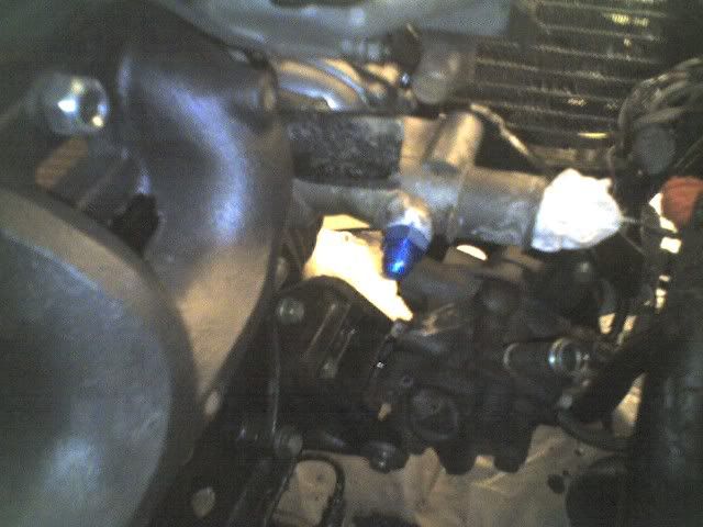

Then I put liquid teflon on the thread of the 3/8 npt fitting and used a 1/2 rachet with a 19mm socket to screw it in. I know a 1/2 is pretty big to use in aluminum, but it was all I had with a 19mm. Problem is, I was trying to get the fitting in as deep as possible since the 9/16 hole I drilled was a little wide at the beginning. I pushed my finger in behind the fitting to feel when it was close to the end of the threads. I may have torqued it a little too hard because about 1/8" away from the end of the threads I heard a faint "click" noise. I about shit my pants. I stopped right there. I didn't see any cracks on the housing and the back of the port felt smooth. I hope I just stripped a thread or too inside and not split the fitting or the housing. Hopefully all is well. The fitting is basically screwed all the way in and does not jiggle at all. So with the liquid teflon I hope there are no leaks. I guess I won't know until I fire her up.
Thanks for all the advice guys :icon_bigg

F#ck me!!!
I cracked the housing :cry:
Not too bad tho. It's just a hair-line crack along the top, right where the fitting screws in. I figure I should remove the fitting, repair the crack, retap the threads to clean them out (maybe even go a little deeper this time) and screw in the fitting again.
What should I use for the repair? I don't want to just use something like JB Weld and then have it split when the aluminum heats up and expands. Can I use something like HTS2000 or similar weld with propane products?
