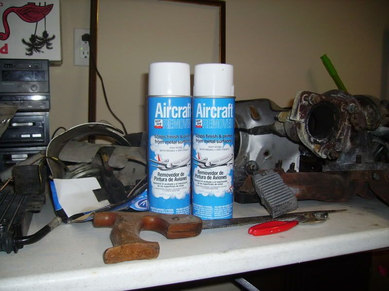

Get a couple cans of Aerosol Aircraft stripper from autozone.
+1 aircraft stripper removes all

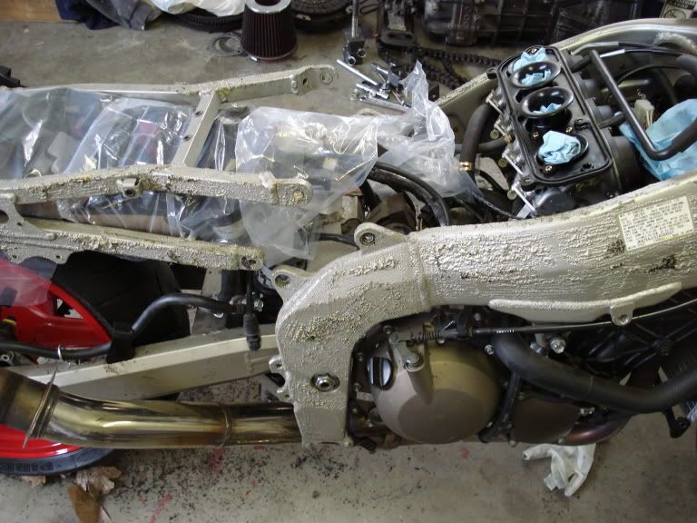

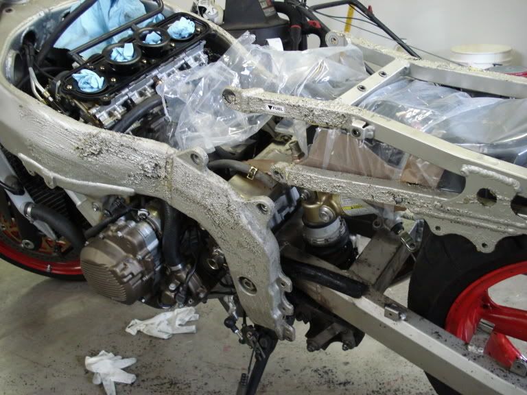

here's a pic of it removing the paint from a motorcycle i'm rebuilding (this was about 15 minutes after the aircraft stripper was put on)

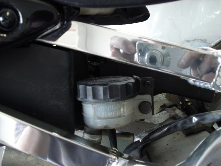

as for the polishing, i don't use anything over a 400 grit anymore... IF i use any sandpaper at all
here's what it looks like with no sandpaper at all..NOTE: only the two bars going up into the black piece (subframe for the people that know bikes) has been polished, you can see before with the aircraft stripper, then after about an hour of work here:
