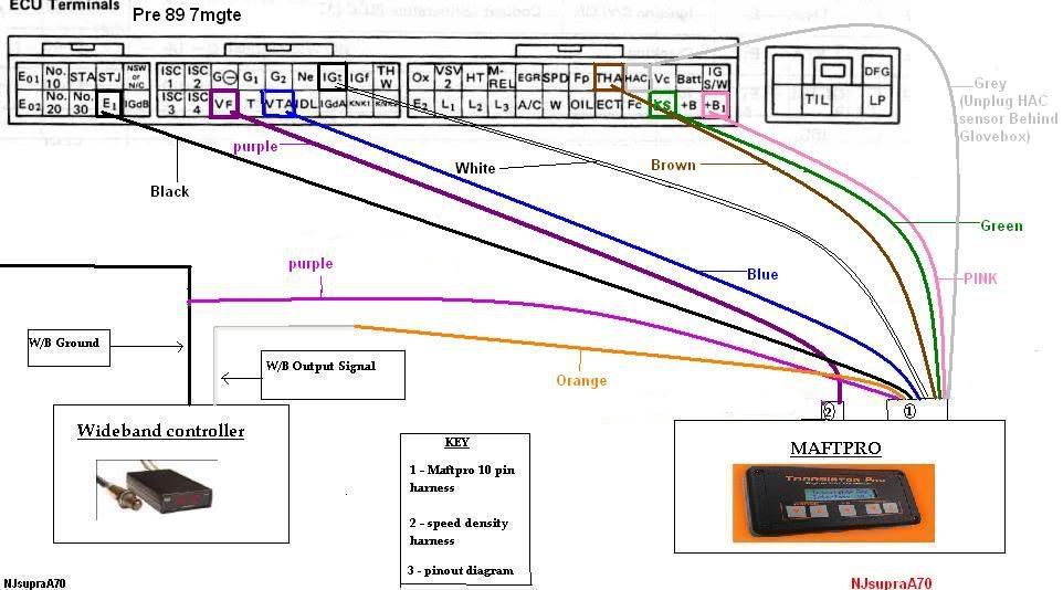

Hey guys i am in the process of installing the maft-pro and I have no idea which wires I have to splice into with the AEM Uego to get wideband readings on the maft-pro. Help please! thanks

According to my UEGO manual, the "blue" wire is for serial output.."RS232 com port for hyperterminal data logging," though the white wire is for "any auxiliary unit that uses a 0-5v signal, such as the stock ECU. I do not have documentation yet for the MAFTPro, so I am unsure what it uses for a signal to datalog, though I would assume it would use the white wire.

Looks like orange to white(not my diagram). I used it to hook mine up, but haven't spliced into the wb yet. In fact, look a few threads down from yours: http://www.supramania.com/forums/showthread.php?t=11783
