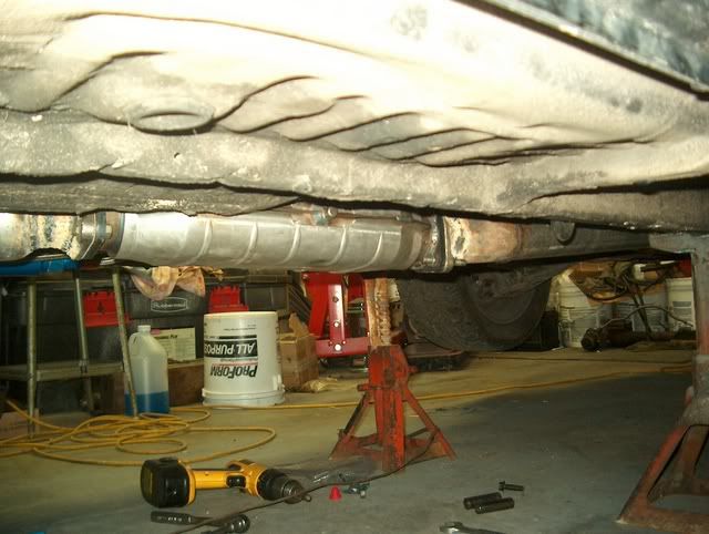

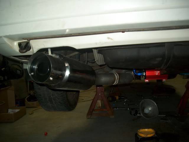

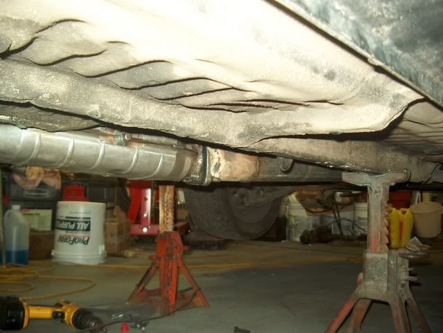

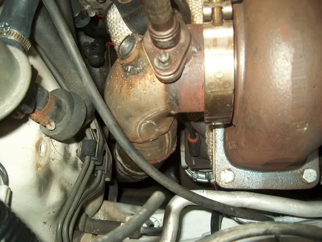

I built my entire turbo back exhaust completely custom. I had to to work with the vband flanged turbo, and the fuel cell. My exhaust exits on the passenger side and works just fine.

ViR2;873374 said:
is that a cat or a resonator? :)
Corect me if I'm wrong, but ends of that cat/resonator are not 3' right? So then why didnt u go with 3' cat/resonator?
That is a full 3in high flow cat.
