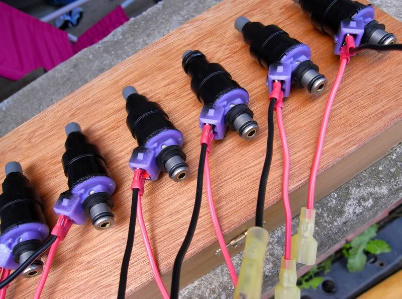

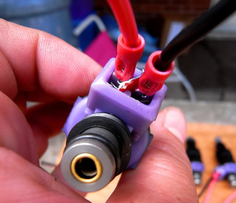

...well... pretty MILD, maybe... but took me a dozen years to finally get 'em!
(Actually, they are labeled as MATSUDA (Mazda) injectors on the box in Japanese... whereas the "original" HKS injectors were "exclusive" product, I think.)
An EVENING job... at first.
^ Pulling TB bolts WITHOUT bending over.:biglaugh:
^ Stuff comes off...
...then... READY for the "procedure"!
^^^ "TRANSPLANT" in a JIFFY!:biglaugh:
^^^ Goin' back together...
^ ...and a WISE impulse to RE-TORQUE!!! (Several REARWARD joints had "relaxed" and lost tension...)
FEELIN' GOOD for the moment.......................................
Hmmmmmmmmmmmmmmmmmmmmmmm....................
^ DOHHHHHHHH!!!!!!!!:icon_evil
There was an apparent miscommunication when I explicitly asked if I needed "clips" to transition from my 440cc stockies to these!!!:icon_conf
..............................................................:icon_idea
crisp
existentialincrementalist
May 25, 2007
1,785
Ohio

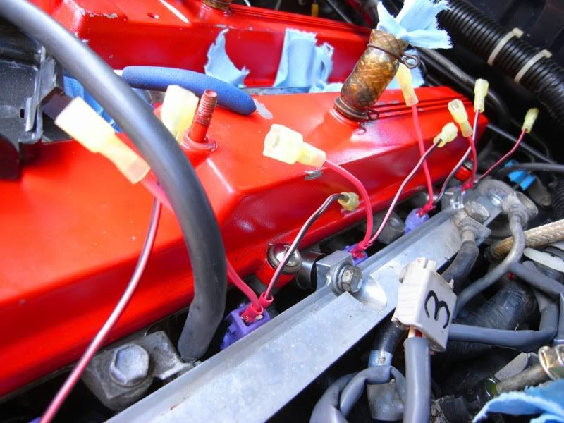

^^^^^^^ .....needless to say, THAT idea went up in.... er.... "smoke"?
It became clear I would need the patience, stable hands, and advanced skill-set of a Belgian Grain-of-Rice Masterpiece Carver to make these two very different connectors "mate"...
hmmmmmmmmmmmmmm......................
............................................................................:icon_idea
^^^ A quick trip to Radio Shack... and a handful of "blade-type" connectors... and an "innovative" slip of "cardstock" to "positively" separate the two connectors (VERY close together... and EASILY an IMMINENT short circuit!).
^^^ Installed and then "injected" (pun INTENDED...:nono: ) and "coated" with RED RTV silicone.

lagged said:
ehhh i dont know if i would trust that.
the clips arent that expensive. horsepowerfreaks.com has them.
...yeah... it was on a weekend... I had NO TIME in my life... and my PATIENCE at the moment was down to less than nothing...:nono:
I also had fun making it work!:naughty:

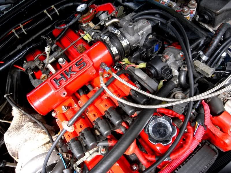

^^^ There it is back together...:icon_bigg

no offense, but i wouldnt have done that to them. something that important i would want the right clips on them. we have them in stock for $30 and could have had them to you the next day. good luck to you tho, hope it works out.
on a side note, what shot are you running?
You are totally right!:biglaugh: We'll see how my haste ultimately affects the "long-term" performance of my car!
On the "shot"... the jets I have are for 50, 70, 100 shots, but I don't run it at all.;)
... I'm an "all-turbo" guy for now.
(On another note... it is set up with a remote solenoid and two heated 10lb bottles through a fogger nozzle off a WOT throttle switch. Pretty basic.)

You are one crazy guy, but I like it!
I like the way you type too :D
Clips of course would have been better, but I call that proper-ghetto :biglaugh:
Honestly, I think that'll hold!
