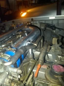

I think i may have found the leak, i dont have an air compressor so i cant do a boost leak test myself, but i think i found the leak. The pipe that runs above the 3000 pipe, its the one closest to the firewall, one of the 2 rubber things was like halfway out. Long story short, i think i found the leak and its real close to the throttle body so that may... have had some effect. I havn't fixed it yet, (going to later or tomorrow), but i got a lead!
Fubar231
Apr 2, 2008
402
columbus
See how the hose is barely connected on that pipe? Could that cause it?

whining noise is the turbo spinning at higher revs, you have a boost leak.. same pressure more rpm on the turbo, hits boost cut earlier etc is exactly the issue, are you sure your intercooler is still ok?
from what i can tell it doesn't cut fuel, just ignition. and its not dependant on boost levels, it depends on load, afm reading, knock counts, temp etc.
i find mine hit boost cut on a hard shift into 2nd gear.. at around 3-4 psi. but would be fine up to round 9psi.
my monies still on boost cut, go keep looking. could be your intake manifold even (where it joins to the head)
you can get some carby cleaner spray and spray round the manifold joins or close to the throttle (too far away and it wont work), if the rpm increase as you spray you have a leak,
