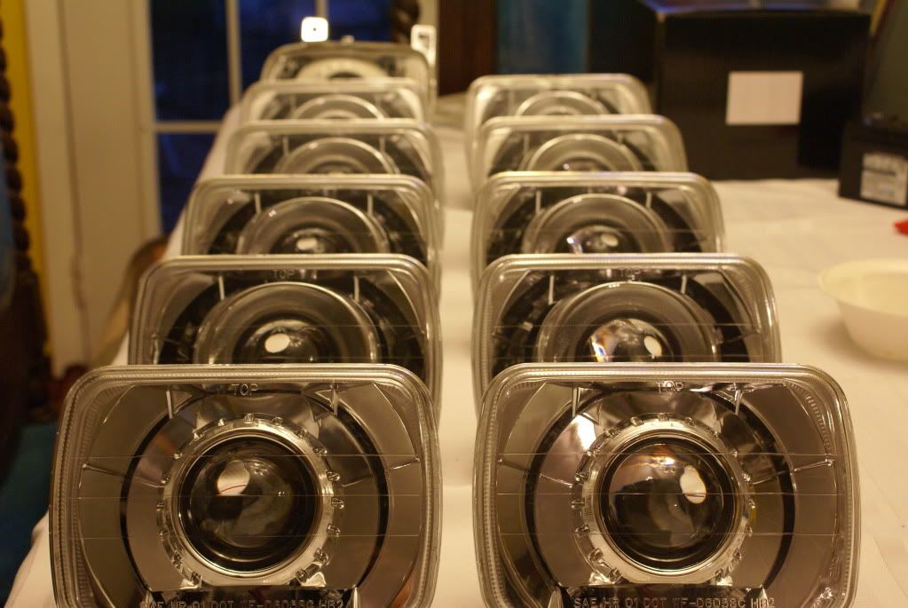

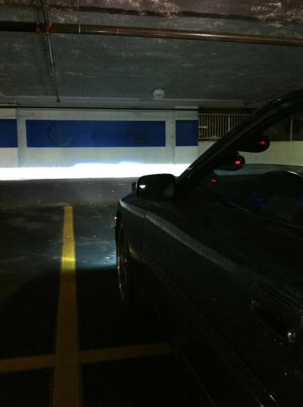

I have tried regular ebay housings, smoked housings, and "projector" housings. All are complete junk from my experience. Buying a 7x6 housing and putting in an HID kit into them may be a cheap alternative to the stock yellow halogens, but it is just a scatter show on the road. I ran this type of setup for quite a while, and got high beamed from oncoming traffic multiple times every time I drove. It throws light everywhere, and not so much on the road where it is needed.

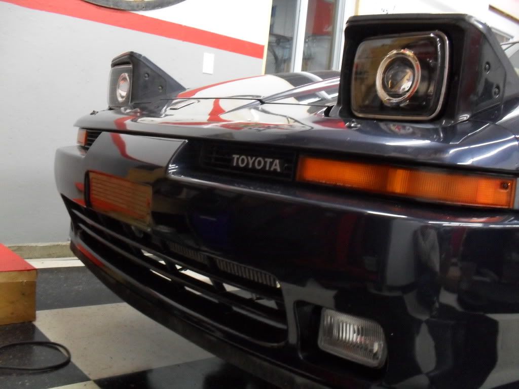

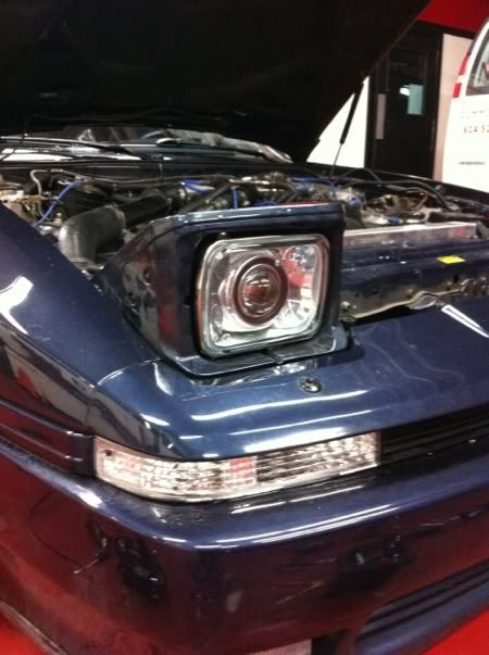

I recently just did a FX-R projector retrofit (with highbeam) with a Morimoto 5000k D2S HID kit, and I'll never look back!
Check out www.theretrofitsource.com for some REAL projectors that work. It is quite a bit of work to modify the housings to get them to fit etc, but well worth it. Ebay housings are great if you plan on doing a retrofit, because they have a clear front lens and are easy to cut up.
Total Cost of ebay housings with plug and play HID kit: $70 ?
Total Cost of ebay housings with a real projector retrofit: $350 plus some hours of labour to custom fit into housings... The choice is yours :)

DamnifIremember... lots. You could search in the for sale sections for threads started by Poodles, it'll probably show up pretty quick. There were some examples of the light pattern in the for sale thread as well, but it basically looks exactly the same as the ones jdemara posted.
