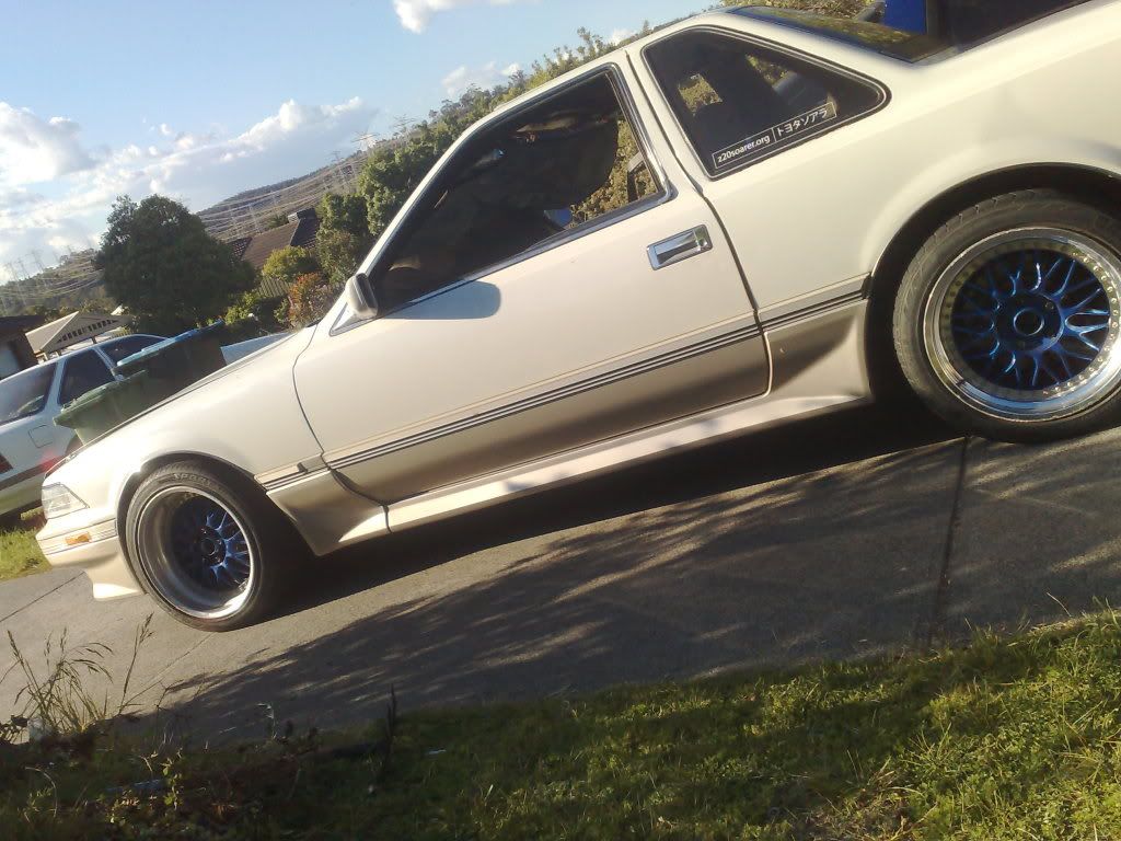

Hey guys Im new here, thought I should post up...
Names BJ, Im from Melbourne, Australia and dont exactly have a supra...(Ive had 2 mk3s...)
I currently have a mz20 soarer aerocabin with 7mgte...
I was looking for some info on some stuff, and found a couple threads here as a start, but havent found the answers I need...
will post in tech section....

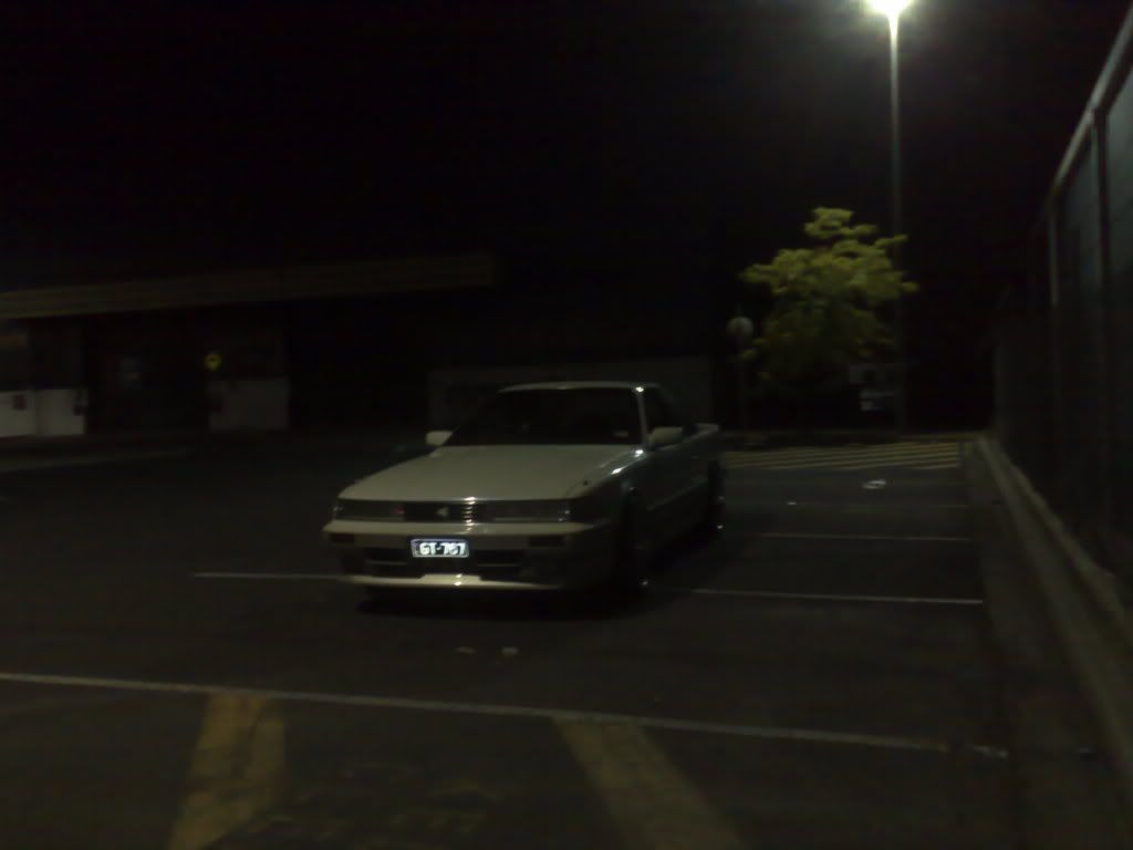

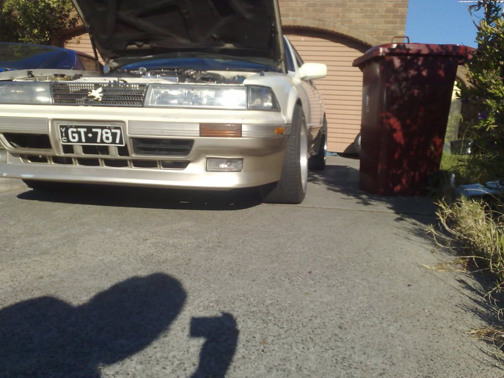

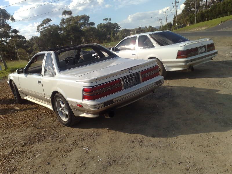

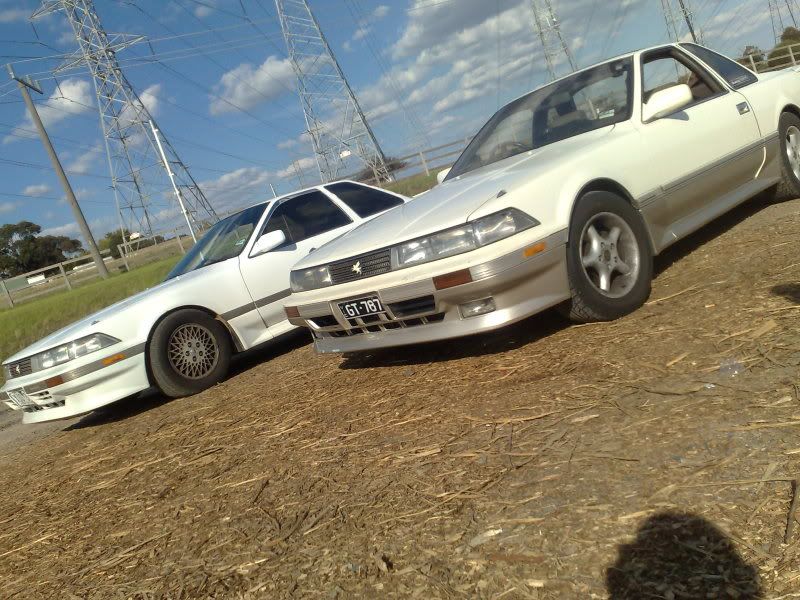

Meanwhile, here some pics of my ride:
mkiiichip
Sep 10, 2007
1,434
WI
Welcome.. Sweet rides.
I dont think we have those in the states. In the last pic, the one on the left is it convertible or something? what does aerocabin mean?
B_JAY
Apr 29, 2010
Melbourne, AUSTRALIA
Thanx man...
Yeah the convertible is the aerocabin, thats my one...
Theres a few of these in Canada, and 1 i think in the US...
Basically its the same as mk3 but coupe instead of hatch...

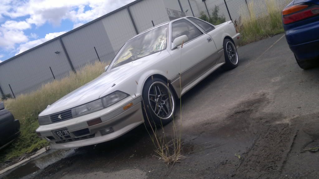

I also have this one, although this pic was a long time ago
I didnt get it in this state, and had an accident , which hasnt been repaired yet
But in its prime:

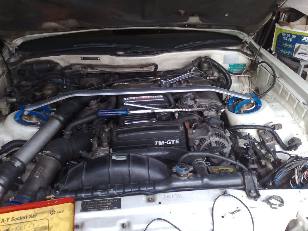

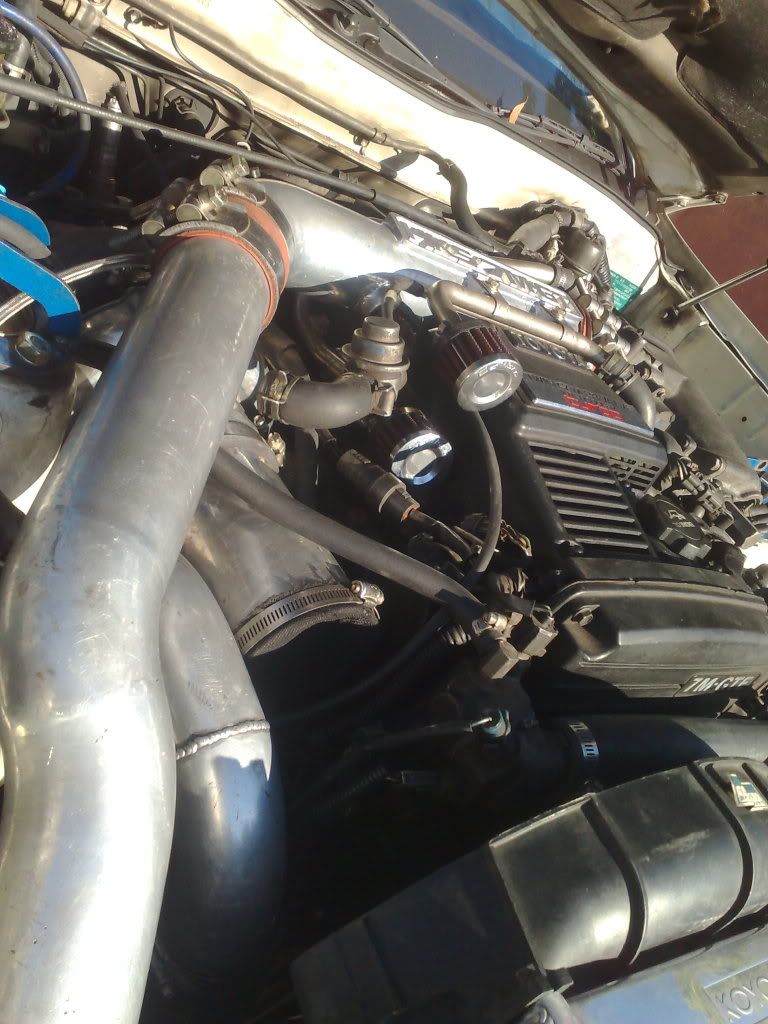

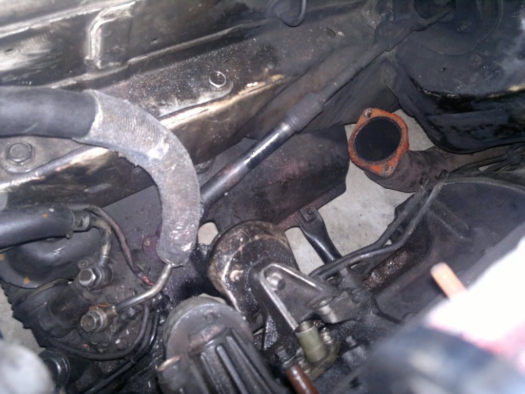

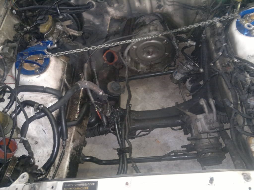

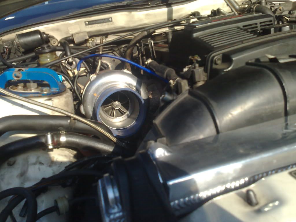

Old engine bay:

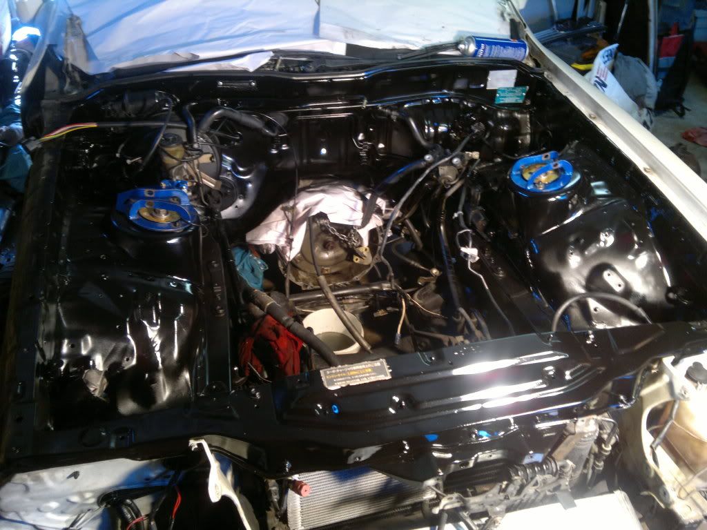

After a few items:

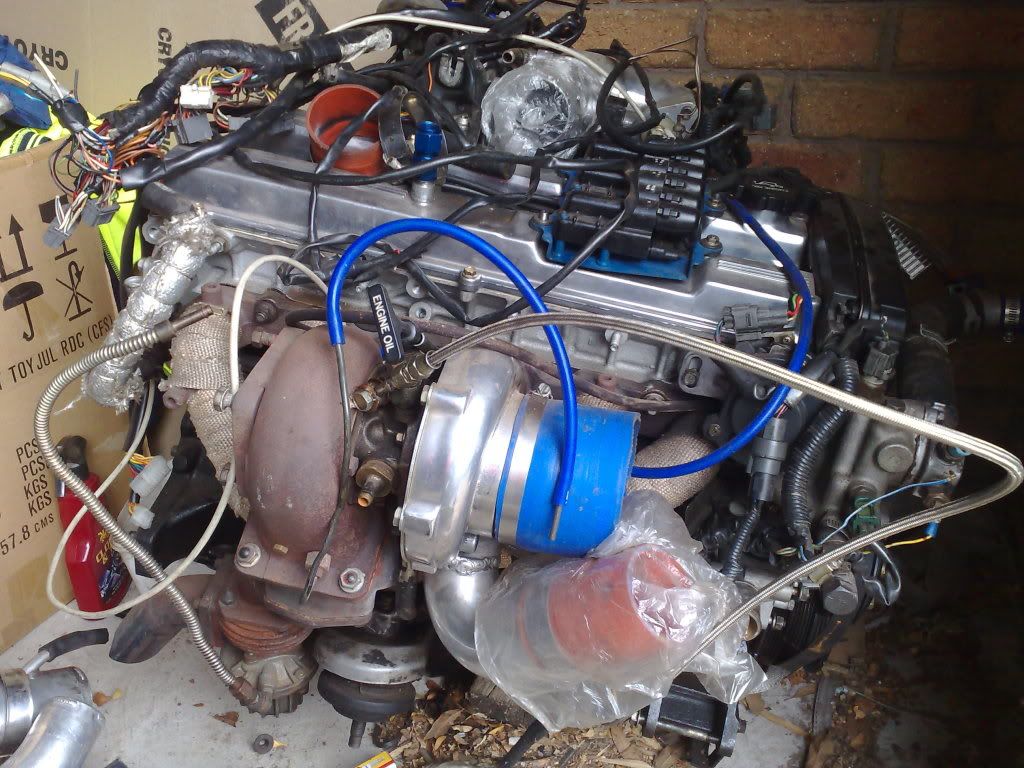

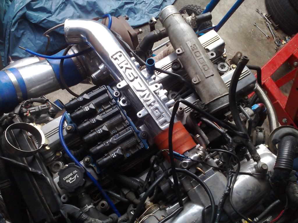

Also had picked this up: (thanks dan for the hks bling!)
more info on motor in link, some things arent right (cams are toda not hks, few bits Ive changed)

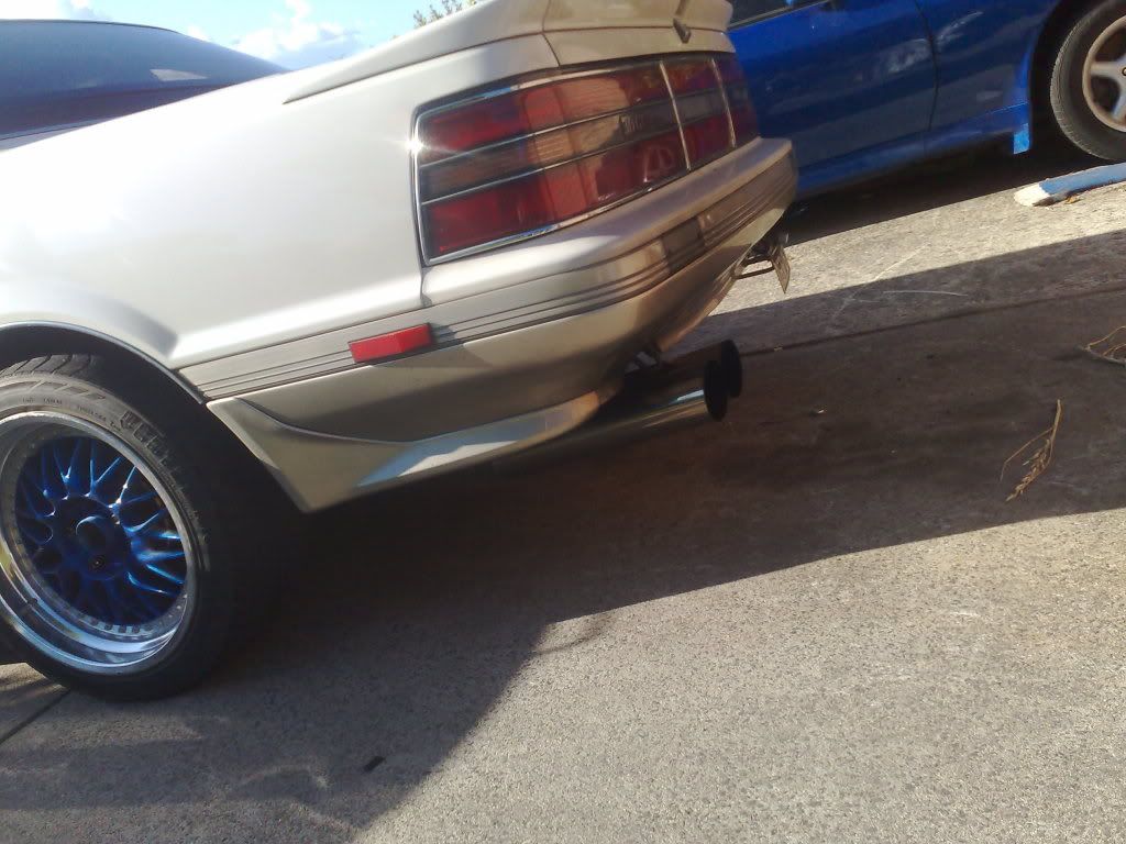

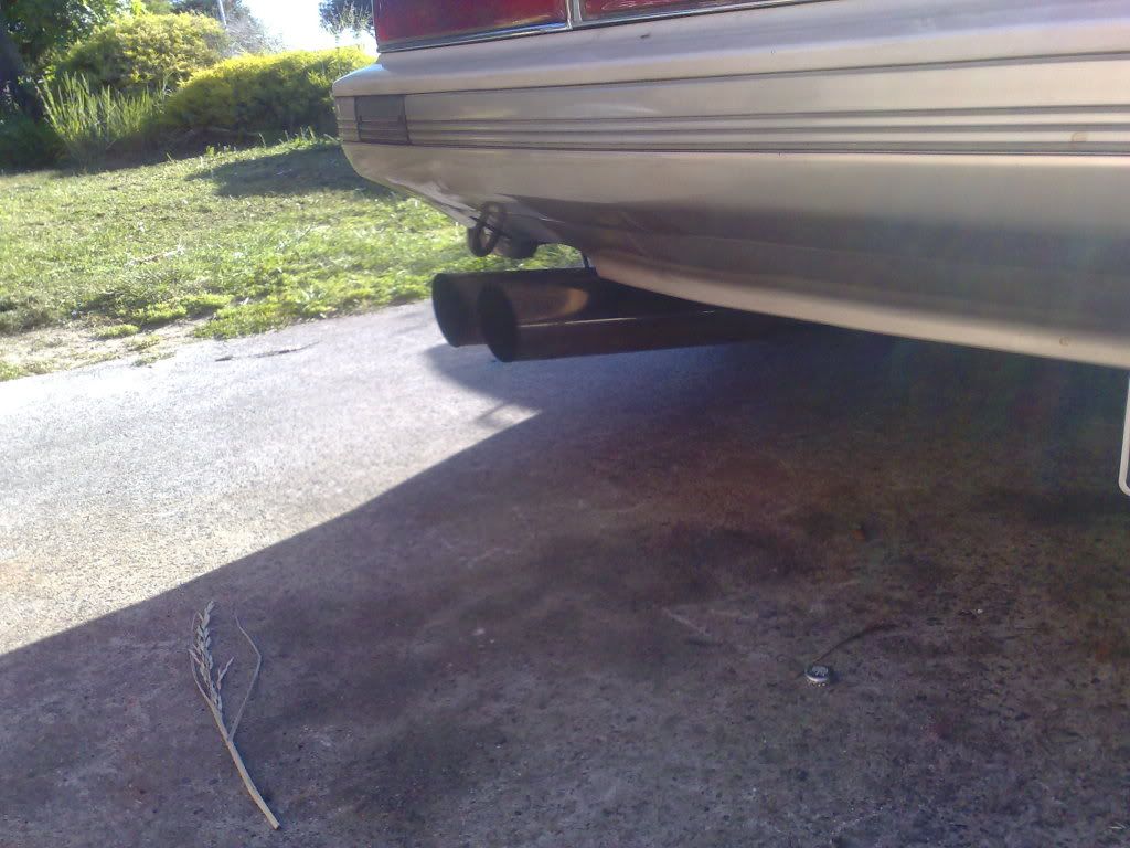

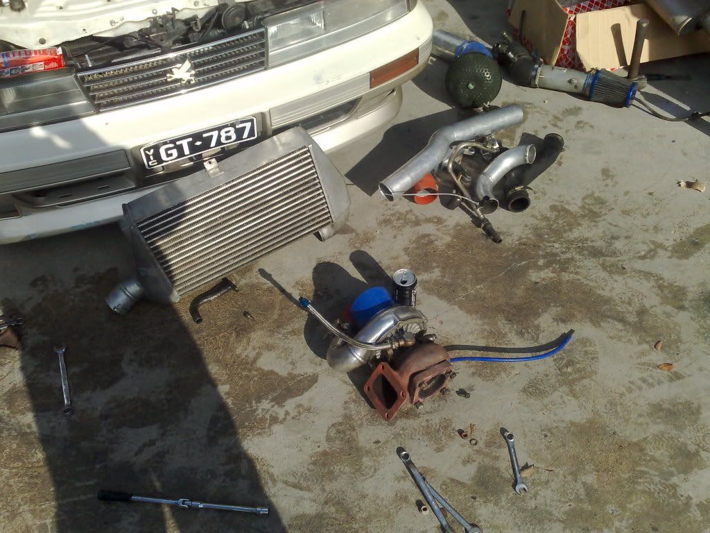

So I stuck the turbo gear on my 7m, along with a jza70 DD catback system (built auto)
So that blew!

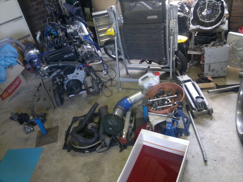

new engine, this was suppose to go in the blue supra in the background:

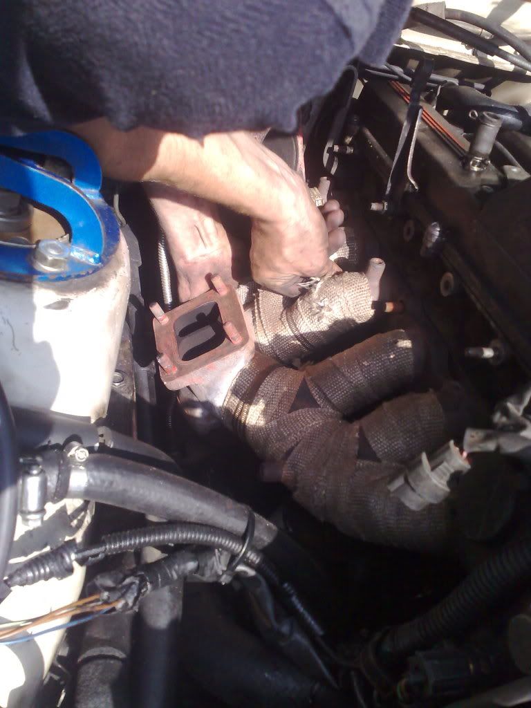

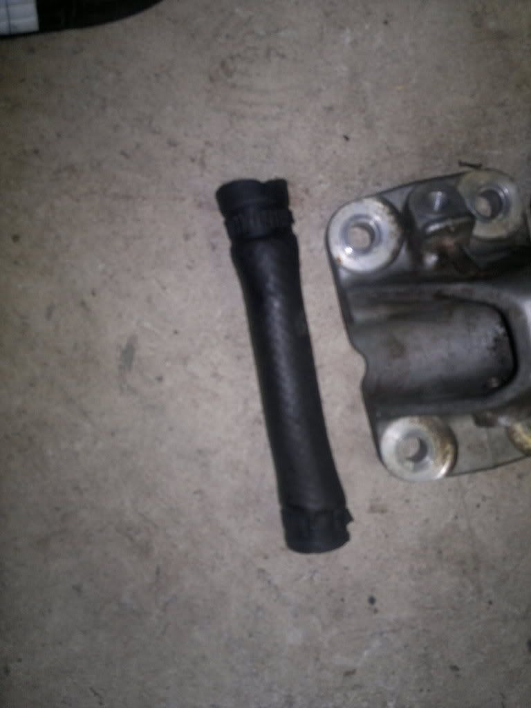

The Culprit:
I didnt even know this was my turbo oil dump line...
If I did, it wouldve been replaced when I did the water lines...

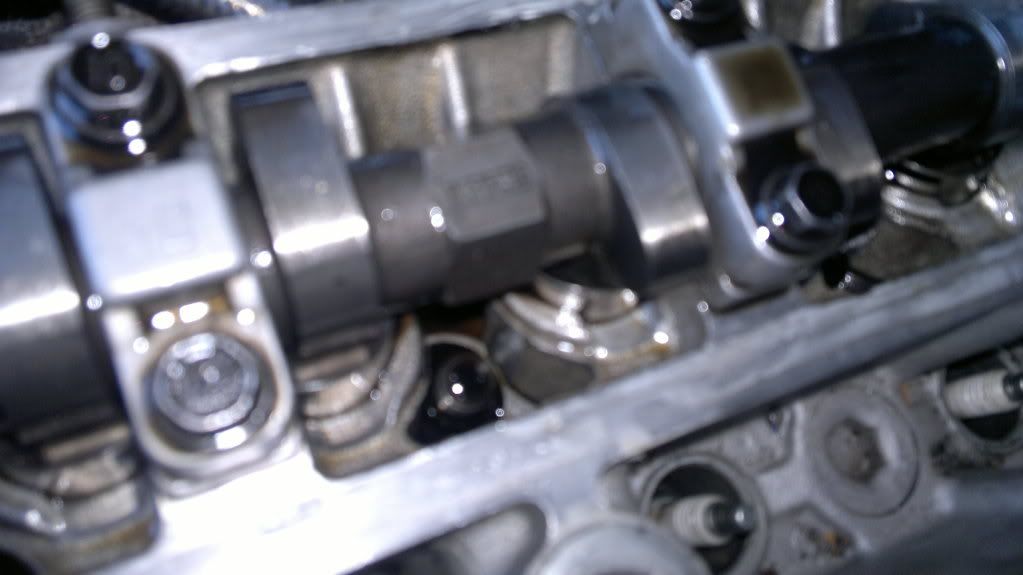

After pulling down the motor (it was a freak low genuine km 7m) I found a s2 block with 6m crank
Quite obvious it was rebuilt like this years ago, most likely before leaving Japan (100% sure not factory built, crank was knife edged, lightened and balanced perfectly)
Lobe clearance

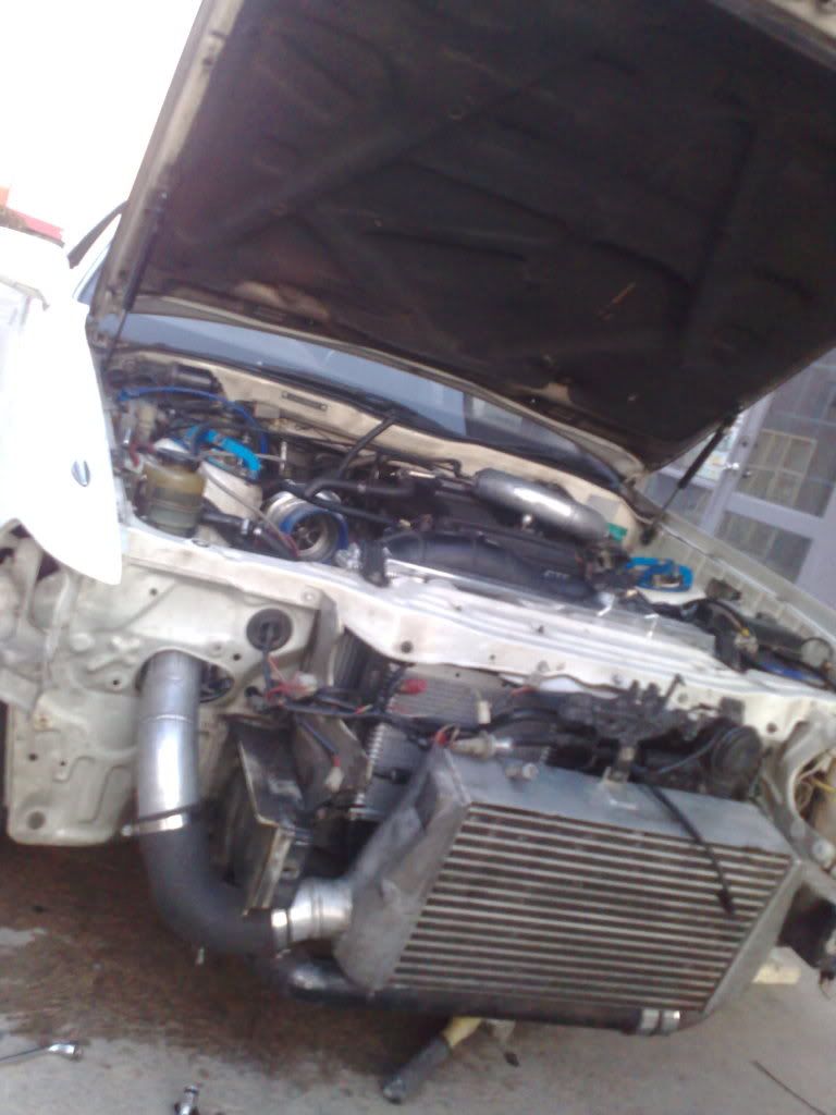

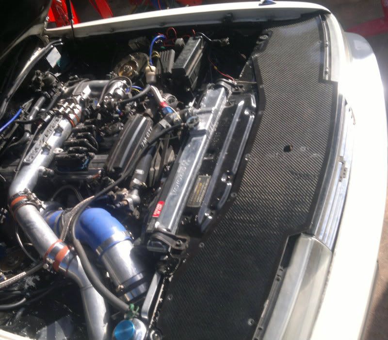

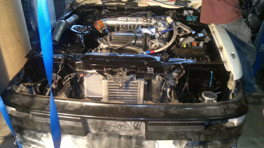

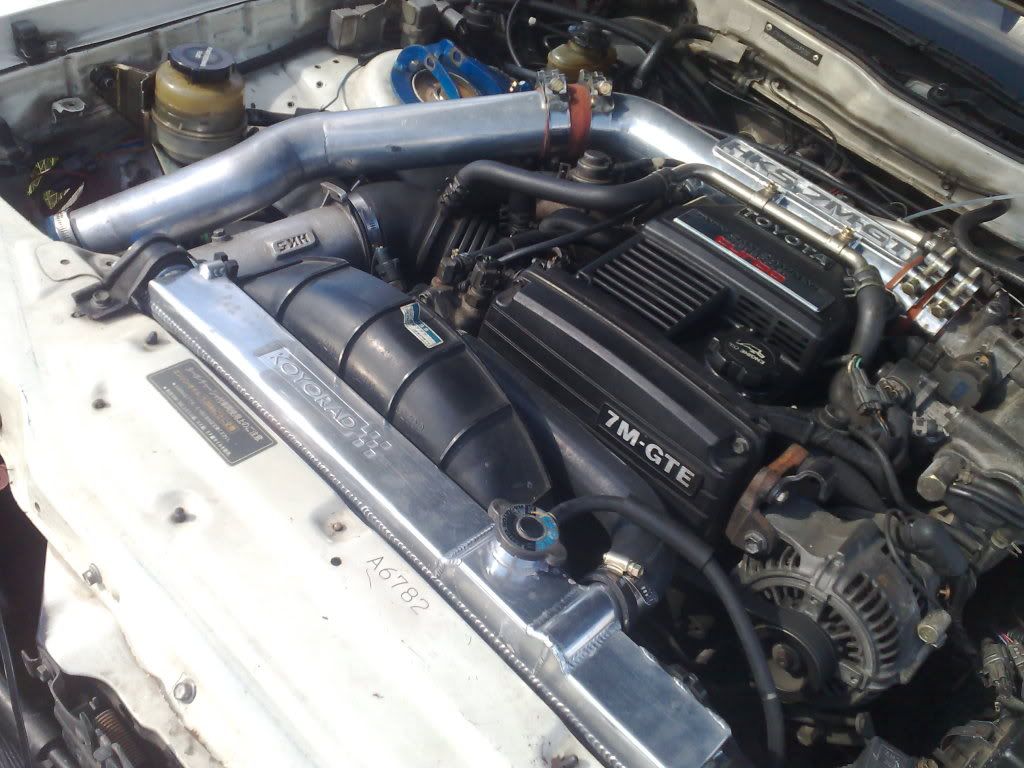

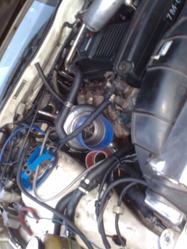

Currently:
Still not perfect, but its an animal of a 7m...
Most of this is a cut and paste:
Engine Mods:
Toda 272 cams
Toda cam gears
Completely rebuilt head
Titanium Valve retainers
Custom high lift Valve springs
Ported head
Completely rebuilt bottom end
Cometic 2mm Headgasket
ARP Head Studs
ARP Rod Bolts
HKS long runner manifold
HKS gate 50mm
t76-R built by gcg
(*I was told it started as a hks t04 then the owner got t-66 front housing, but the plate says t76-r custom built by gcg)
HKS BOV (broke this, now removed pending rebuild)
HKS 7M-GT crossover pipe
Polished cam covers
Braided recirculating rad hose mod
Braided every line just about
Samco the rest
Microtech ltx12s and hand controller
Polished Turbo A throttle body and Intake manifold (so I've been told, its the right size I/D)
Blitz 4" thick intercooler
Blitz 2" oil cooler
850cc injectors & custom fuel rail
Tomei fpr
gtr fuel pump (I need to upgrade this for full power)
4 inch hks pod filter

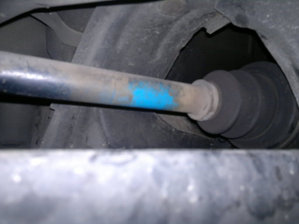

Found these under my aero
definately not factory (not smooth like factory ones, milling marks all the way around/along them and blue)
Mate says theyre cusco but I cant find anything online about them
does anyone here recognize these?
havent been able to find out what brand they are or where they're from?
(if not I'll post a thread up, theyre drive shafts or half shafts, dont know of any other name US specific but they go from the diff to hubs)
