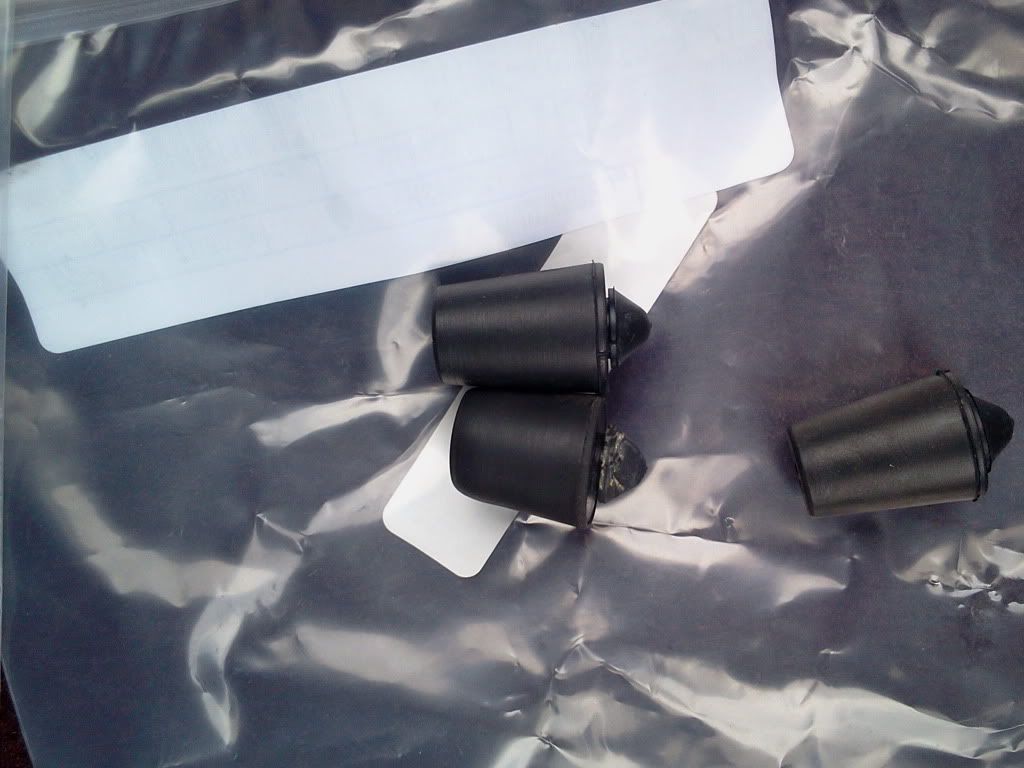

The problem with your hatch bouncing around may be your bump stops. I also thought mine looked good, but my hatch rattled so I decided to replace them, and it fixed the problem. On the bump stops that go on to the body of the car you could see very small tears in the rubber where it supported the hatch. The round bump stops on the hatch were also considerably shorter than the new ones, from all the years of the hatch's weight compressing them.
The top one is the new one, and the bottom one is the old one.
After I replaced the bump stops it fixed the rattle, and the hatch now has a very solid feel when it is closed.

I got the bump stops from toyota.
The part numbers are:
90541-09047 x2 round bump stops
67293-14030 x2 square bump stops
90159-50116 x4 screw for square bump stops
In total all the parts were like $40-50
