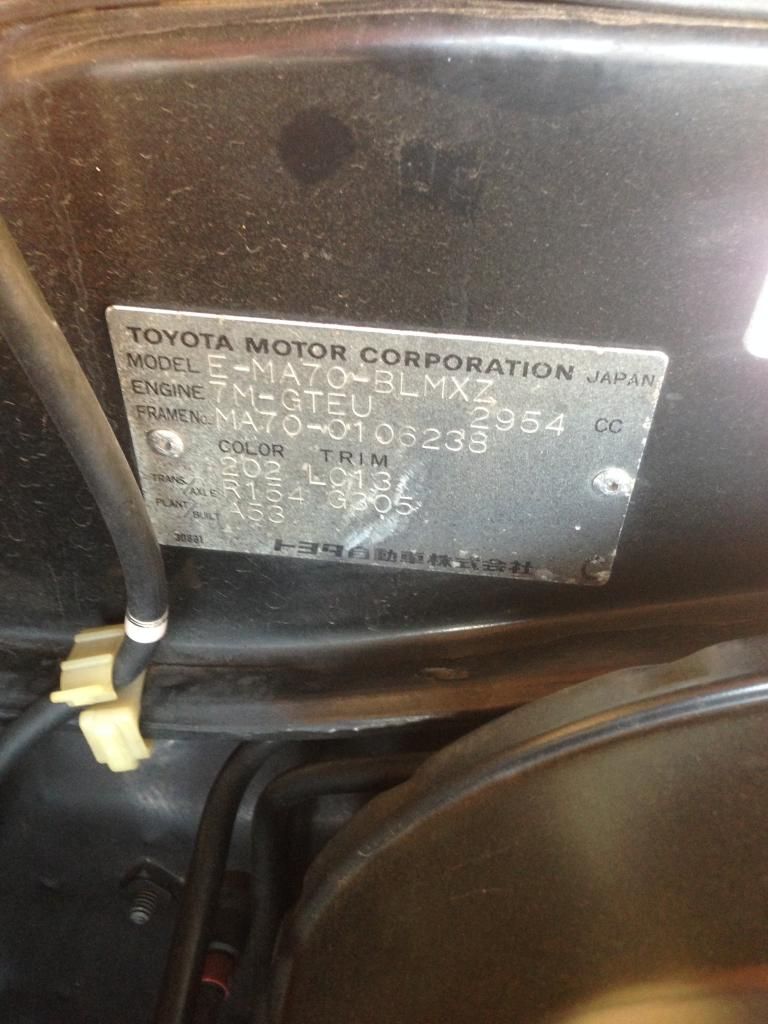

Do you have your vin, I work at Toyota and I can see what the part number is and all that good stuff.
Will have to wait till tomorrow if I can remember to check for you.

It's a Japanese VIN though so it wont show up in your system. But it should be the same parts as the US counter part. I believe the same piece is on the non turbo engine also?

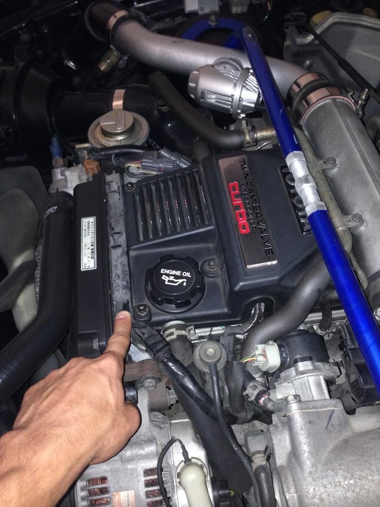

That comes with the wiring harness only. And iirc all wiring harness are disconnected.
Really?! Thats gay! Its a separate piece though :( Do you know the part number for the harness that it came with (there are a couple of different wire part #s). And your sure you cant get this piece separate?

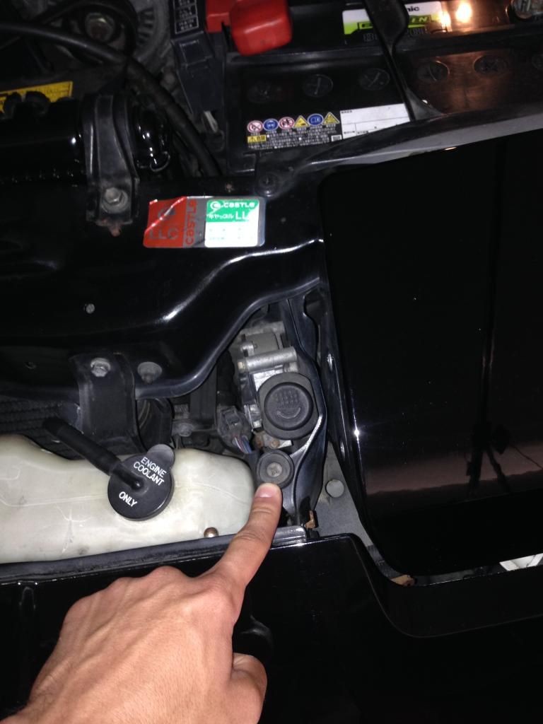

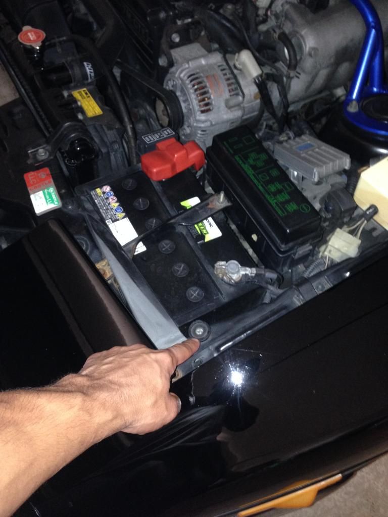

Thank you for the part number! There is a picture for a "Type A" and "Type B" ... is that because there are 2 different types on the car? One type for the 2 in front and the other for the type in a little more back?
Yeah it's a long shot for the harness, but I was gonna send some feelers out in Japan and elsewhere. Really need that plastic piece and it wont hurt to have a brand new harness if I can find one
3p141592654;2022460 said:
Hood bumpers are item 53382 in this link
http://www.cygnusx1.net/Supra/Library/EPC/291420/catalog.aspx?F=5302&P=1
I don't think you'll have any luck with the wiring harness, even the later cars have been discontinued for a while.

We can still get both types of bumpers though Toyota.
One type is 53382-90k01 and is 9.40 each need two.
Other is 53382-14010 and is 5.32 each need two.

Okay just looked it up and that piece is a part of the harness
And they are no longer made.

Heres the P/N for the turboA harness
82111-1B290 might still be available in some Japanese warehouse its about $1100 USD though

Can anyone help me find the part number for the piece in the picture? I can't find it :( It's the plastic part with the wires going through it.
I couldn't find one either. Its like they get cooked in the engine bay and fall apart. I rigged up my own using hi-temp wiring loom. I will post a pic tomorrow when I have the car out. I would be very curious to see how others routed their wiring harness across the valve covers. (hint: post pics if you found a clever way to do this)
Sorry, not trying to hi-jack the thread. I doubt if we can order just that part so work-arounds are required.
I wonder if another model from Toyota uses a similar part..

I used split loom wrapped with self-bonding tape (SCOTCH 23). But, given the historical importance of this car I can see how that would not be satisfactory. The only alternative I can think of would be to try to find a used one from a cold climate that has not turned to stone.

Can you or a friend do some 3D modeling and possibly have access to a 3D printer? I would think one of those would make quick work of that piece.

Good idea but really need to 3D scan an oem one to get the size right. Also, the plastic would have to handle the punishing temps of the engine bay.
