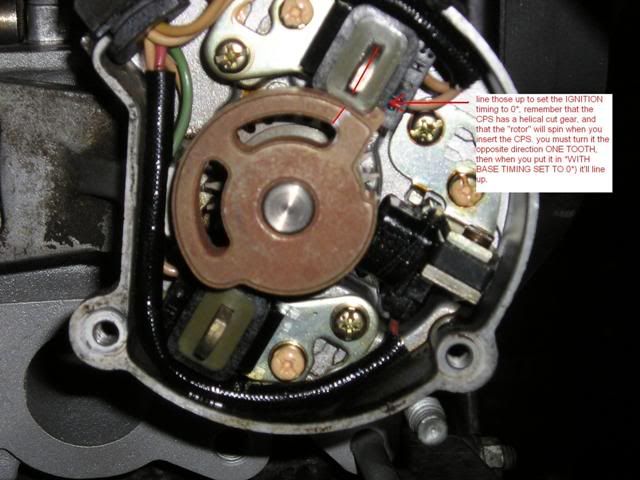

that's correct on how to set the BASE timing. you need to set the ignition timing after that. (10* BTDC) here's how to do the IGN timing:
place a jumper wire in the terminals T1 and TE1 in the diagnostic block, hook up a timing light, one lead to positive battery post, other to negative, and the pickup to the #6 spark plug wire.
start the car (making sure that no wires are in the way of belts, fans, pulleys, etc...) crack loose the one bolt holding the CPS stationary,(keep it relatively snug so it wont move) press the trigger on the timing light and watch the notch on the crank pulley, and turn the CPS until it matches the 10* mark on the timing cover. :)
the cylanders are numbered 1-6 from front to back. on the coilpacks, they're numbered like this: 1-6-3-4-2-5
sounds like maybe your CPS isnt installed properly.

here's how to allign the CPS:
-shaeff
