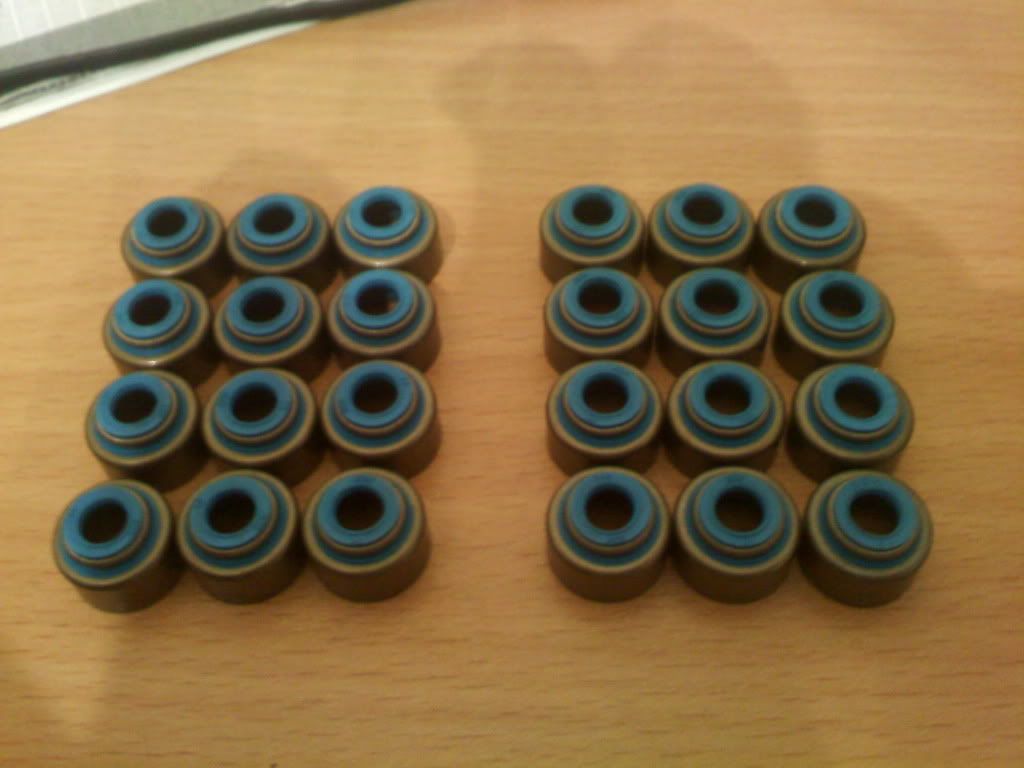

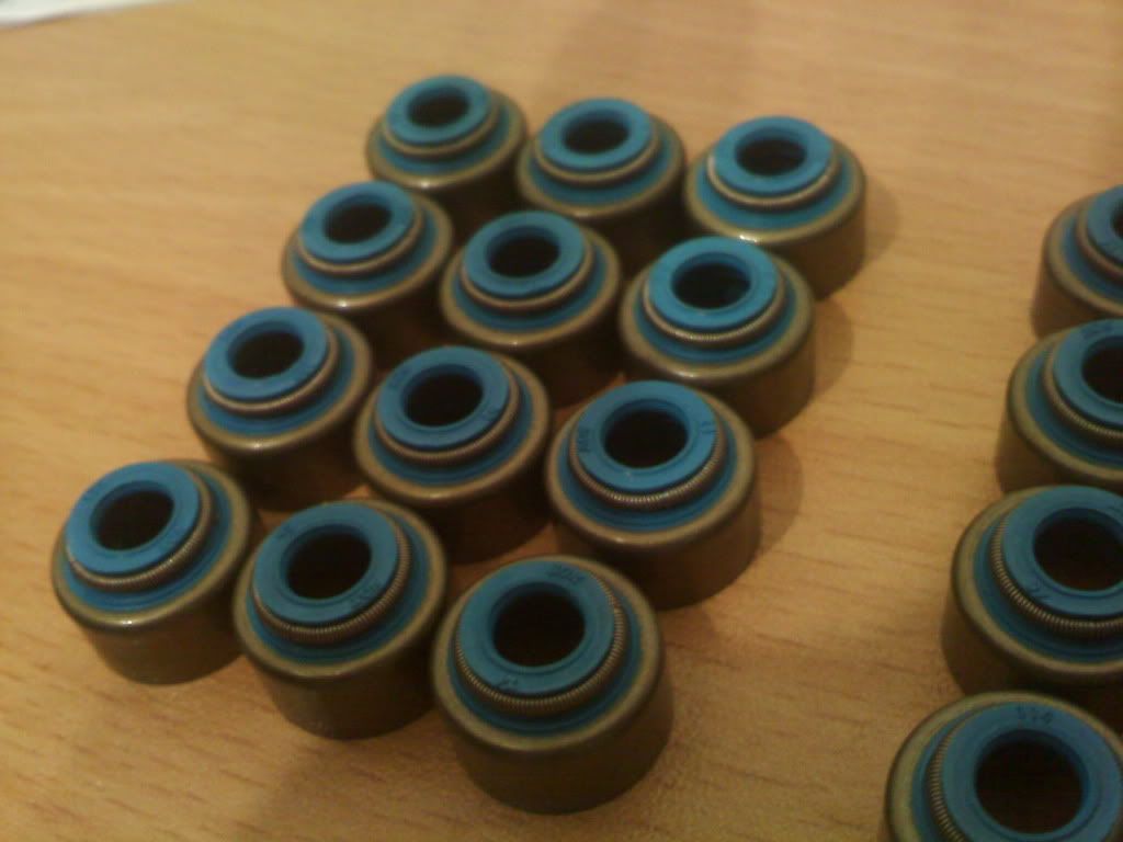

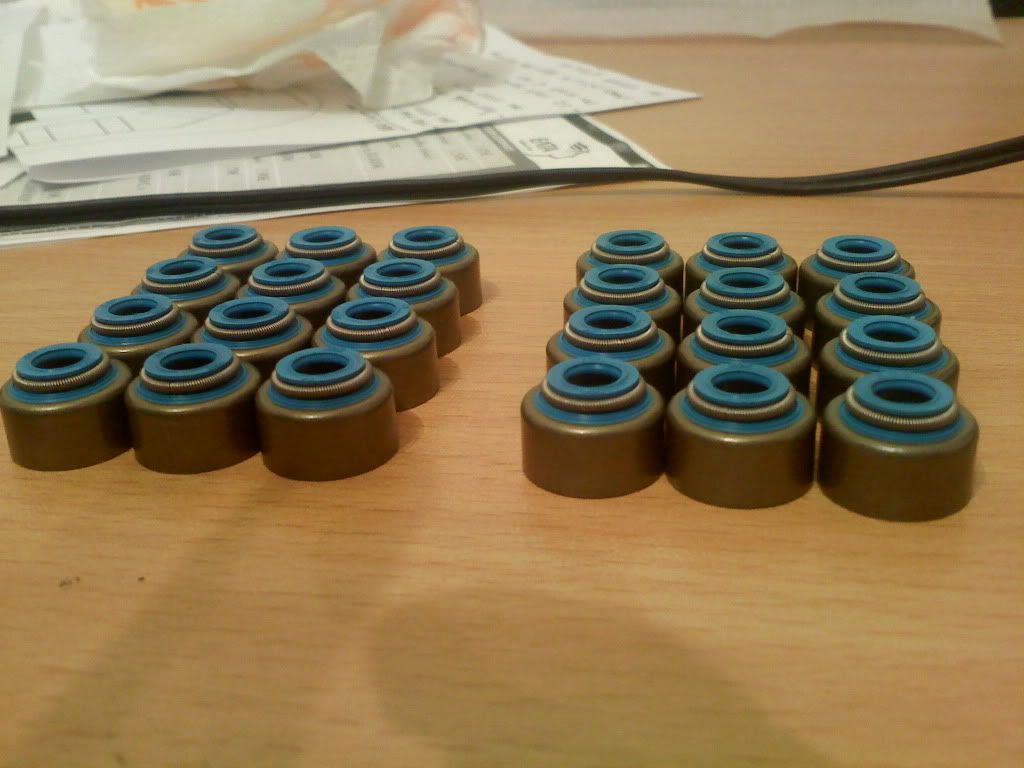

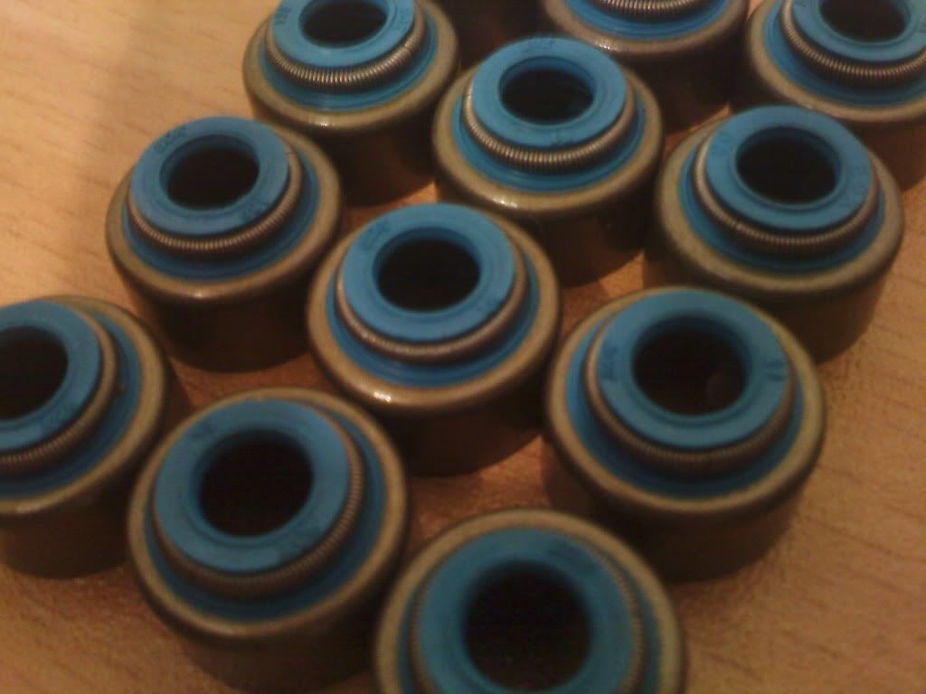

SupraClaou
Sep 1, 2006
846
4
Athens,Greece
Here are some picts of the Ferrea valve stem seals:
(They all have the same colour,height,outer/inner diameter,etc.)

The viton seals I got with an aftermarket gasket set are slightly different (just checked). There are 12 which are somewhat grey (gray) and 12 which appear "copper'ish." just a tad darker than the grey (gray).
If yours all appear EXACTLY he same, then you should be allright.
