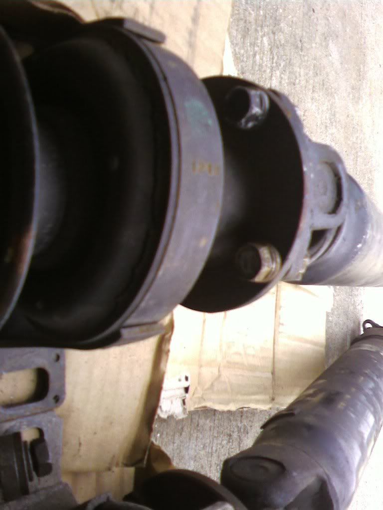

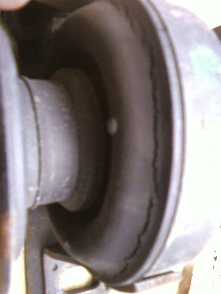

ok so is this safe to use?
its a bit cracked.... pictures:
So? yes or no?
jdub
SM Expert
Feb 10, 2006
10,730
Valley of the Sun
That's the rubber in the center bearing...I would not use it. The DS will shake, clunk, etc.
DAMNIT
so where can i get a new piece?
or do i have to replace the whole center?
jdub
SM Expert
Feb 10, 2006
10,730
Valley of the Sun
Well, you could always try the one you have...depends on what you think your time is worth if you have to drop the DS again and replace it anyway.
If it were me, I wouldn't use it.

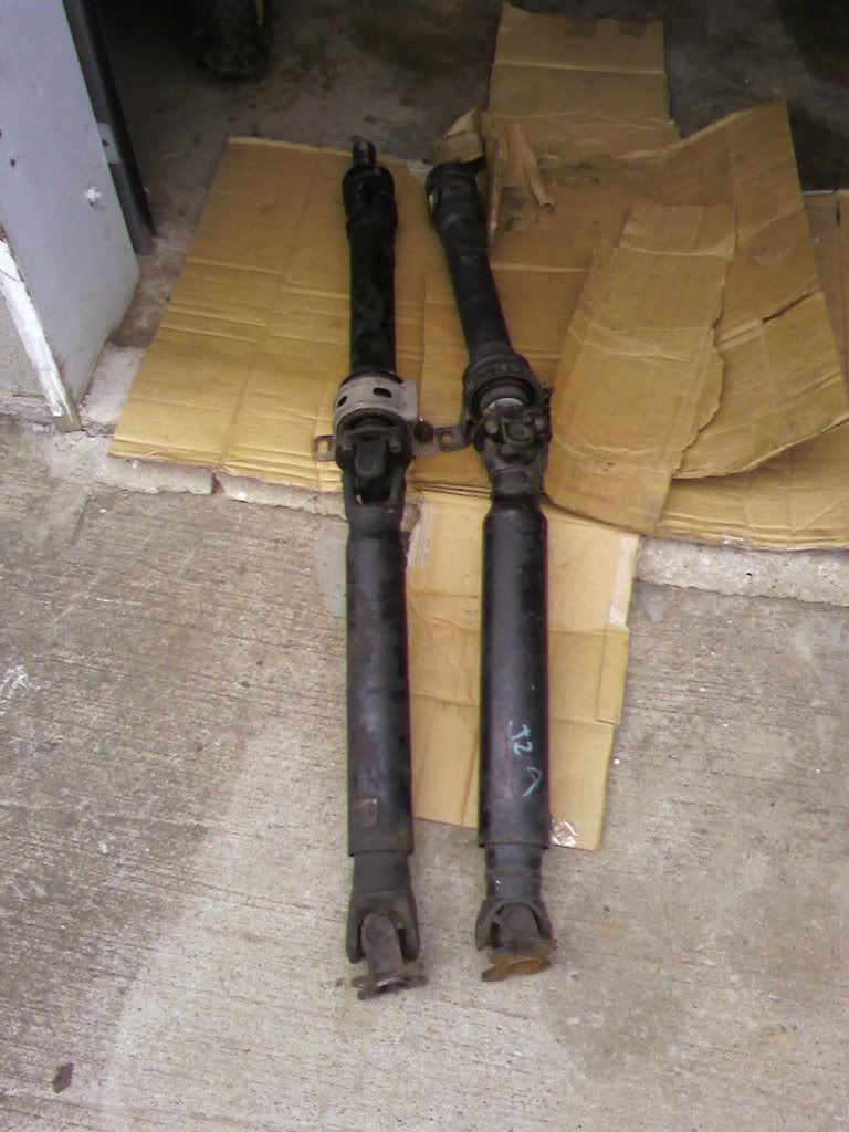

2jz swap, so I need something that isnt going to fail, I dont want to replace the DS again. The other DS is from the W58. So it wont mount up with the R154.

Well the W58 one I pulled is perfect. and it has 200k miles on it...
