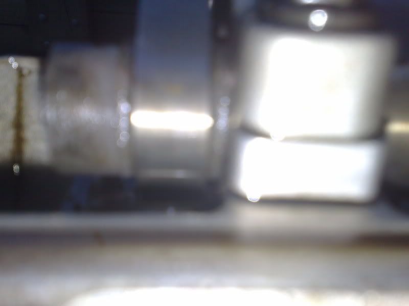

i had a similar noise, i told my machinist that i thought the cam cap was shagged, he laughed at me and told me to check the clearance between the shim and the cam @ 0 lift, i found a 0.25mm gap (using a feeler gauge)
i pin pointed mine by holding the engine @ 2000rpm while listening with a large screw driver on the rocker cover...
heres a pic but u cant see it good
