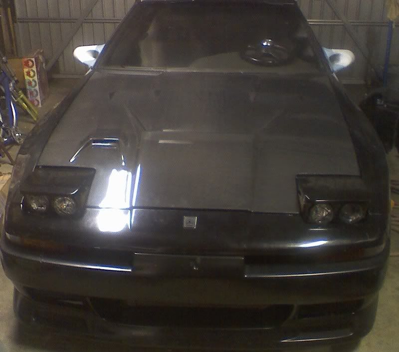

Those are not 90mm hella in that picture. If you want an accurate pic use supranick car for reference.
Those lights came off a sport bike.
