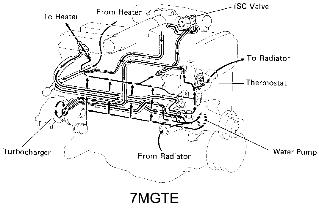

O, forgot about the other side! Sorry i meant to plug the hose lol but that would be... raggedy looking of course, or you could use a coupling to run the right side to the left?

here ya go:

That theory is not worth the effort...and it won't make any difference as far as keeping the engine cooler. Not to mention you'll have no heat. If your heater core was leaking I could see the point in removing it.
In fact, you are reducing the total capacity of the system by removing the volume of coolant. When a car over heats, turning the heater on full blast aids the system in removing the excess heat.
