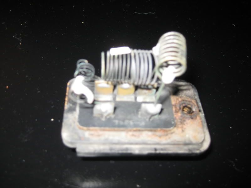

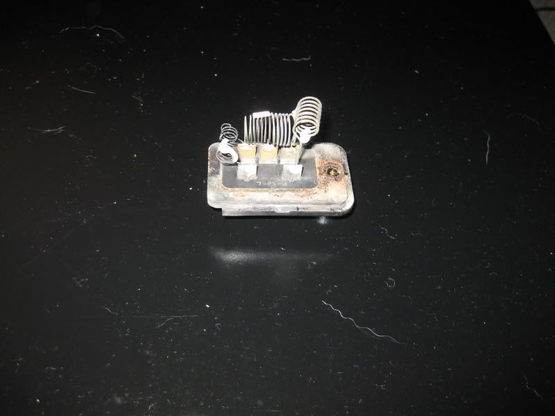

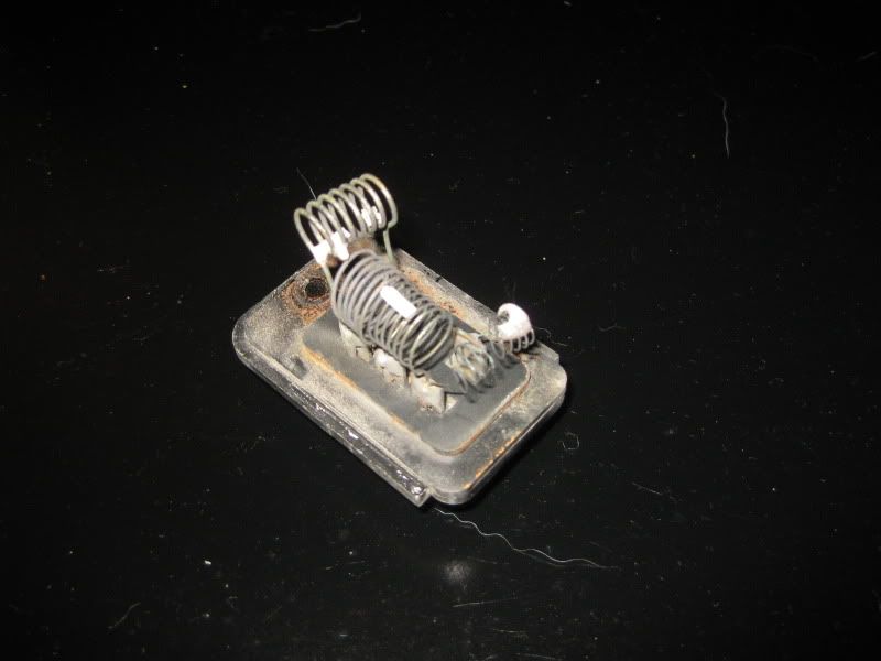

ok so i just got home from work so i go to take it out.. and it seems pretty bad i guess.. you guys be the judge lol
this is the only pic of a good one that i can find..
im not sure about how i am going to fix this?
is everything supposed to be connected with solder?
