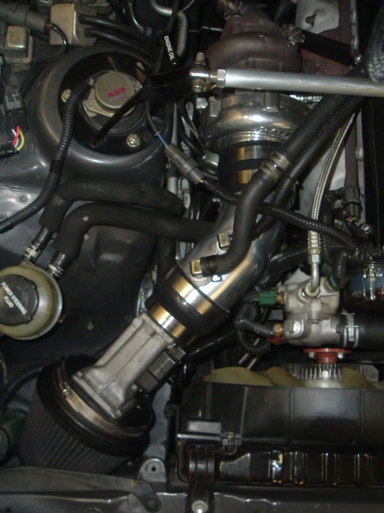

Boss Jr. = you can make the OEM heat shied fit/work.
Boss SR. = NO!
Need to specify what boss turbo Greg is building you ;)
Boss Sr. in pic below
