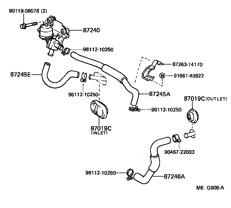

there is a heater valve on the firewall that work's off of vacume.if it's not working right,you can put a zip-tie on it till you get a new one.

Pic of said heater valve:
Closeup of where you need to zip-tie up if it's malfunctioning. See that little plunger rod on the bottom? Right there:

Yes thats the valve I was talking about, how do I know if its malfunctioning? I tried to move the plunger by hand and couldnt.. I can get a picture if it helps.

If you can't move it (it's usually a bit difficult), then I'd replace it. Go to a junkyard and look at a bunch of Toyota's, as there are many that use the same valve, and if not, you can at least use parts to rebuild yours, if I remember correctly.
Your best bet would be to buy one new, because then it'll last another 20+ yrs. ;)

I probably could move it but im afraid of breaking it being that it is 20 years old and this is my daily driver. Which way is it supposed to move so that the heat works? Im still not sure its my problem, right now the plunger is all the way out as far as I can tell..

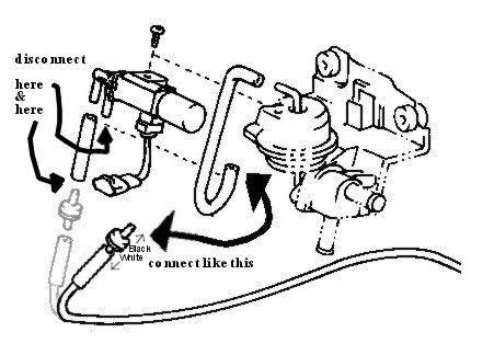

check the solenoid first. in the pic you can see the vac line going to the diaphram, there is 2 on the solenoid just to the left(not in pic) take the one that goes to the solenoid and put it to the diaphram with car running, if the diaphram actuates, its the solenoid. mine was "open" infinite restance with a ohm meter connect to the plug you CAN see in that pic. hope that helps :icon_bigg
bypass it and you can have heat in the meantime

I can move the plunger by hand, how do I go about zap strapping it so its stuck open? right now the plunger just returns to the "down" position if I force it up, which way is open?. I cant get to school today because the car is frozen solid so its a bit of a problem.

Lift the plunger in the UP position, and use a zip tie, or a small piece of bailing wire to hold it there.

Thats what I figured out this morning, bypassed it by pulling the vaccum line off the switch and connected it to the port on top of the diaphram/plunger thing, heat works and it still adjusts like normal..
