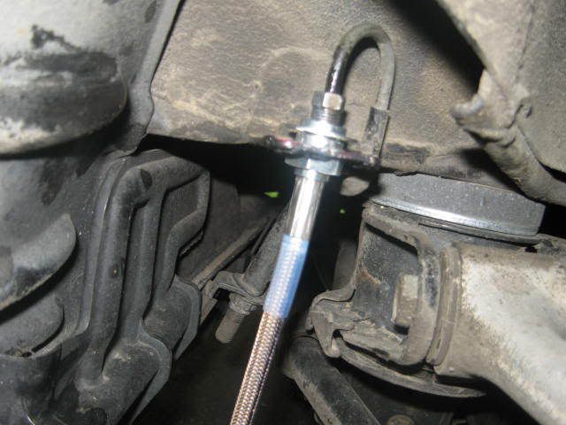

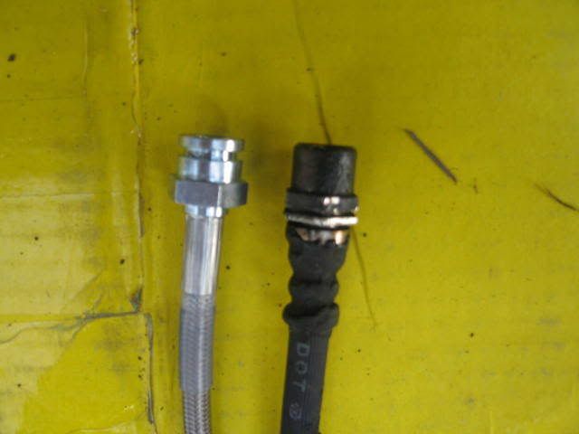

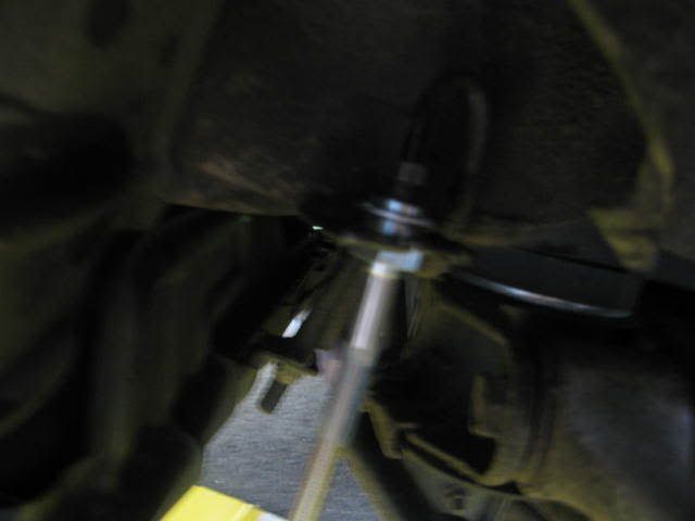

Has anyone ever installed these? These things seem to be requiring modifications. Look at the pics compared to the stock rear line and the rear line installed, fronts have the same issues.
Seems that if I install them the way I did, there is a space between the washer and the stock mount and it wobbles everywhere. I can probably shim it with some washers, but these are brake lines im working with and I would like to install them properly. Anybody have any ideas?

Yeah I have them and had the same problem. Also on the front if you route them the way the stocks, thru the hole, they move around on bear metal unless you put some kind of bushing made of rubber or something. Still haven't found something to put in there to keep from rubbing the braided lines.

I had the same problem with a different brand of lines, went to NAPA and picked thru there selection for a clip to make up the thickness needed to make fit tight. So I now have a clip below the bracket and one above. The ones I used have a U shaped profile on the legs of the clip. They ended up being very secure. This might be your fastest cure to your fitment.

I went through the same problem. If you dremel out the stock clip bigger, you can put that on the "big" side of the new line, and fit another clip into the receiver groove on the new line. Sorry I don't have any pics but its fairly straitforward.

Their appears to be two problems. One is the length of the front line which is quoted below. the other is with the way they clip into the stock mouting brackets. their seems to be excessive movement because of where the clips are located.

This problem has been around since I first put Earl's lines on over 12 years ago. No aftermarket fitting I've seen is a direct replacement for Toyota's. The same problem was there a few years ago when I replaced the hoses.
My solution was to file the spring clip larger so it would fit the new fitting, and then put in a thin aluminum "washer" I made. The washer is maybe 1/32" thick with a drilled round hole the right size to fit on the lip on the new fitting. The hole in the tab on the car is too big; this "washer" fixes that. Mine are simply square as cut with snips out of an old sign I found. Put the washer on the hose end, poke the end through the tab on the car, then clip in place. Works like a chimp.
