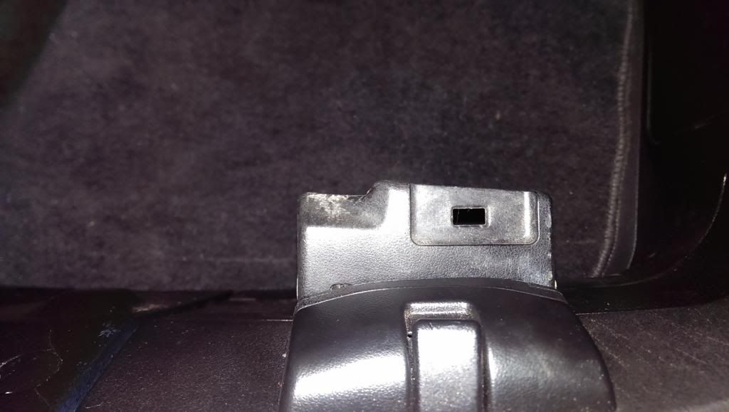

Oh snap! I think I know what your talking about. They have little lines going through them don't they? Dammit! I saw those things laying around in a pile of bolts and I'm not sure what happened to them. Where would I ever get replacements?

The front holders have spring loaded tabs that fit in the holes on the targa. Engage those first, then push the roof towards the front (compressing the spring) and drop the rear allowing the rear bolt bosses to "snap" into their respective notch on the rear holders, then let the front springs push the roof into those notches. Once installed roof should be solidly mounted, certainly not just gravity

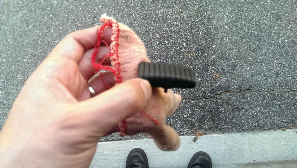

Mine stay up fine, just looking for one of those little rubber pieces. The passenger side. I found the driver side one, but the passenger side is gone.
Anybody have one?
Anybody have one?
This is so funny. I have one on my garage workbench and had no idea where the hell it came from. I'm missing my other one so I had no idea I was even missing anything.
They appear to be a few bucks each in the EPC, but this seems unlikely to be still available from Toyota.

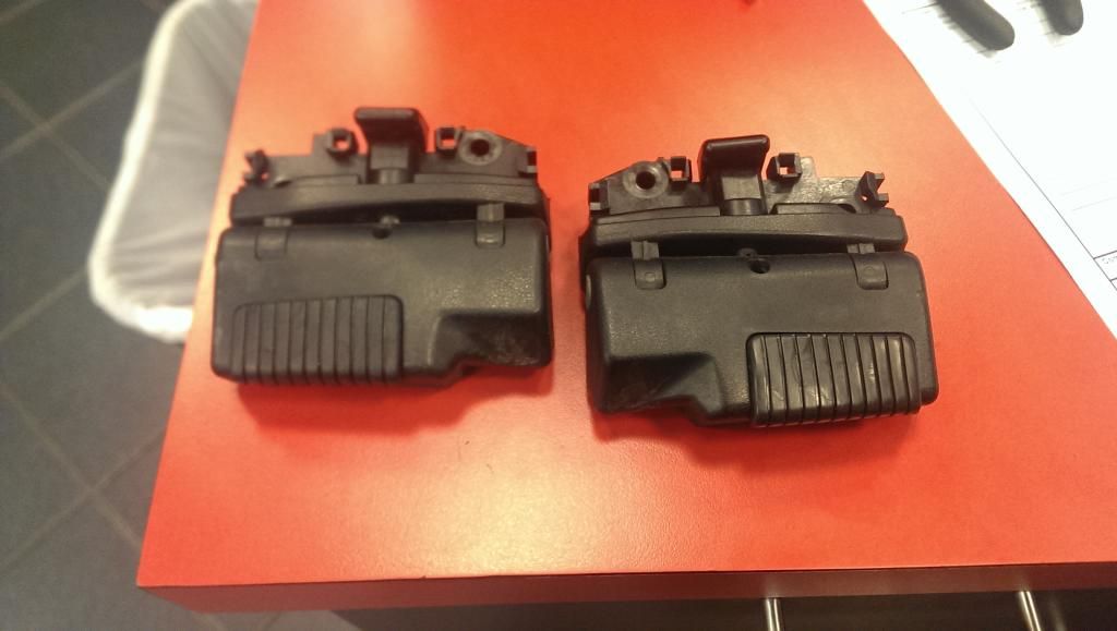

Is it for the passenger side? Segments on the side would be opposite of the one I have pictured? Care to send it to a fellow SM member?
Do you know the part numbers for these thing? I was looking online and couldn't find a listing anywhere.

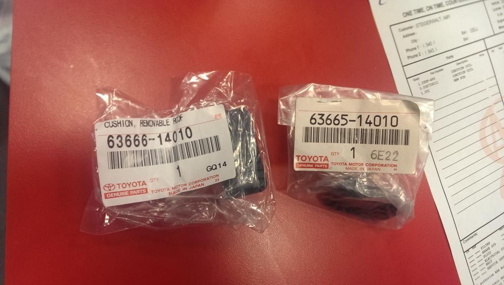

Parts (I believe) are:
Left: 63666-14010
Right: 63665-14010
http://www.cygnusx1.net/Supra/Library/EPC/291420/catalog.aspx?F=6104&P=3
I don't have an extra, I'm actually missing one! I now need to find a driver's side so I have a complete pair.
