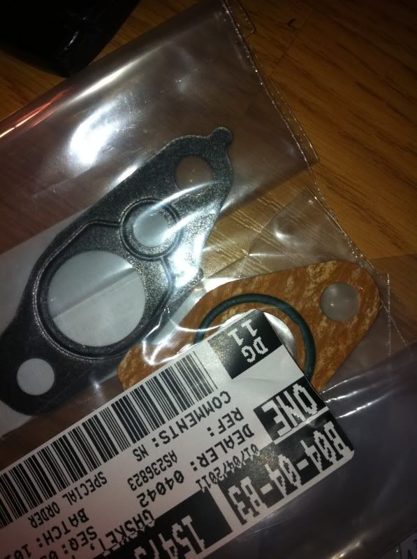

Exactly. Just make sure you have Toyota gaskets.
They look like this:
And of course New copper crush washers for the oil feed line.
MA70L-BJMVZA
Dec 8, 2010
11
Virginia
^^^ What he said. I just fixed my turbo oil leak caused by a substandard aftermarket gasket. Bought the Toyota gasket in the pic above, installed it, and surprise, no freakin' leak.
