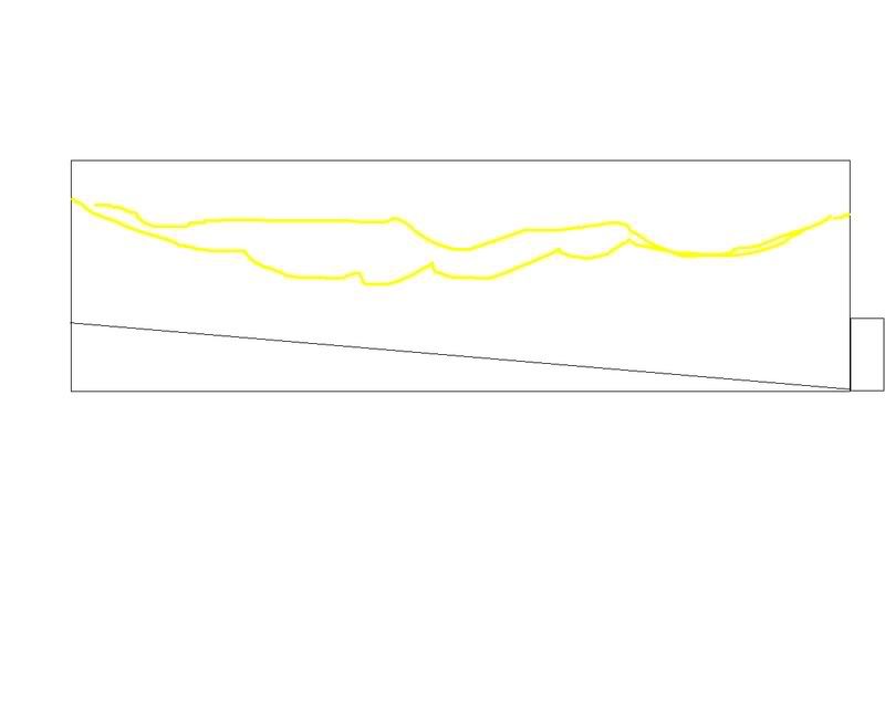

now most peolpe will weld in a sump i want to but i just don't have the time nore can the a1000 fit in the fule tank soo an idea came to my mind
see the stock tank has a drain plug why not make rectangle box weld a screw fiting to the box and screw the box onto the tank and in run my feed from there
seam like it will work and not have any issues

pic's mad tigh ms paint skillz and if i remmber wrigh that drain plug is huge

It would probably work well, as the tank would gravity feed. Maybe make it big enough to fit in the straps, so its not relying on just the fitting to hold it in place? Might have to make some longer straps, though.

with the feed over to the right, like weld in a pant that directs the fuel to one side?
oh thats a side view BTW

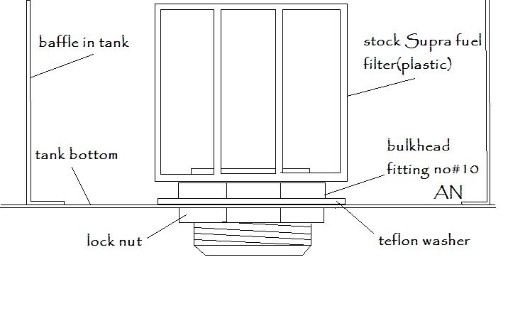

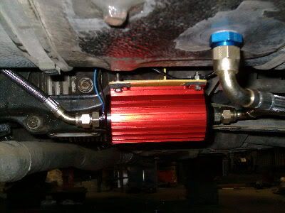

if it were me (and how mine is done) drill and tap the bottom of the tank inside the stock baffle. run that to the pump, or aux tank, whichever you prefer.
dont forget to run a pre filter.
edit:
pic of what im talking about-
how it is installed inside tank-

mine isnt welded. its just drilled and has a bulkhead fitting like i showed above.
good luck with the drain. you'll be the first ive seen that doesnt leak without welding.
