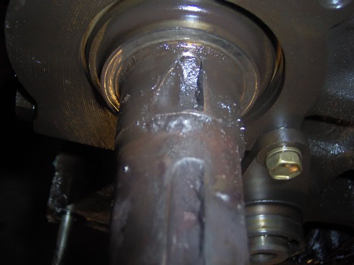

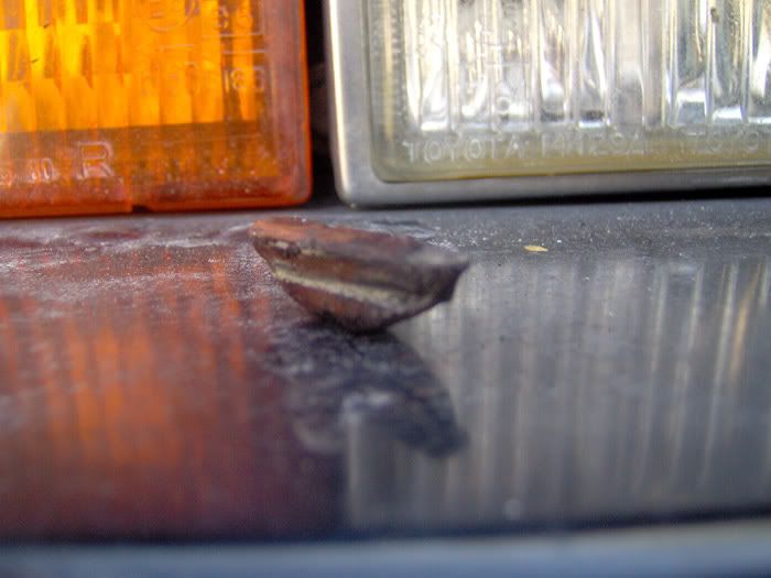

The Key is a semi circular piece of Steel and the Keyway is the Groove it sites in and another on the inside of the balancer to stop it spinning.
Usually if the balancer has been run loose it shags out these parts allowing it to move.
(not 7M parts just for illustration)
Key
Keyway

Check the keyway in both the HD & the crank. If the one on the HD is ate up, get a different one. If the one in the crank is ate up, well, JB Weld might be your new buddy....

eh, JBWeld can't answer every prayer. If it's chewed up too badly, there's almost nothing that'll save it, even if you had new metal welded in.
I just said screw it and bought a crank kit for $280
