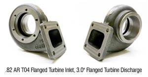

Bought the old HKS kit with short runner, and looking to replace old turbo that was included. Looking around, I see ATP has a version of the GT35R with a T04 flange. Anyone know if its a whole different housing, or just a different flange?
Also, the downpipe to exhaust housing connection on the kit is funky... a 2-bolt collar clamps the pipe into a recessed groove on the turbine housing. Definitely not a v-band, but what is it? I think I read that it's "european" but I haven't seen it before...

you talking about this one?
that looks like a v-band but they arent calling it that. it looks kinda shallow but maybe its just the pic/angle. the euroflange you are talking about looks different than that.

yep thats the freaky euro style thing.
you would be much better off buying a v-band turbine housing and then welding on a v-band flange to your dp.
depending on which setup you used you might have to modify the dp anyway.
